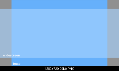

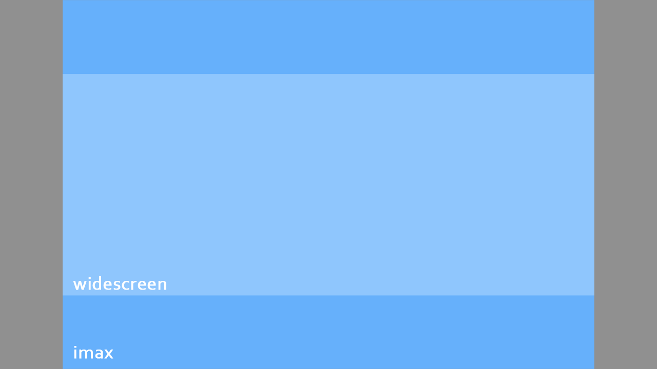

  5. Here are your two basic options in a Blu Ray frame (either is better than 4:3):
ID:	21437Click image for larger version
    If you go for the second you are losing significant image quality for almost the entire film. You can project it bigger, but it will be fuzzier.
