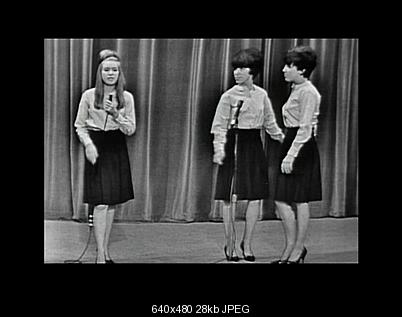

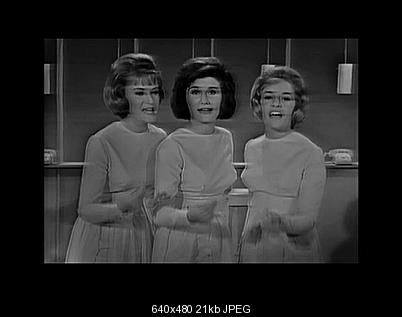

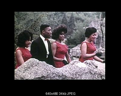

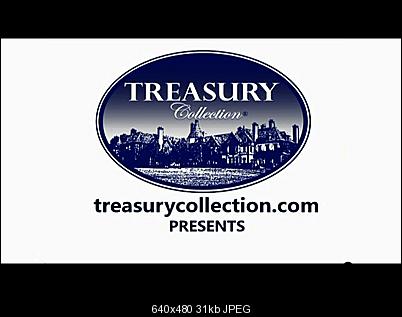

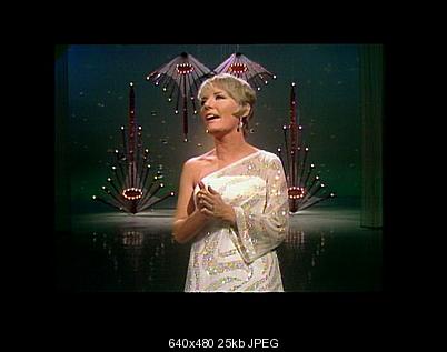

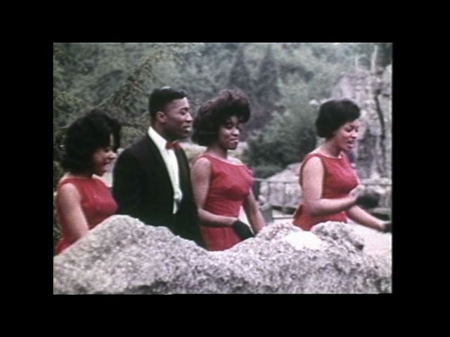

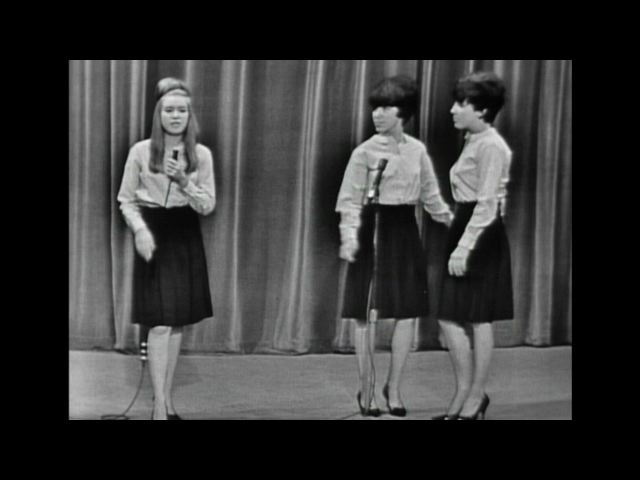

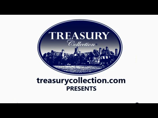

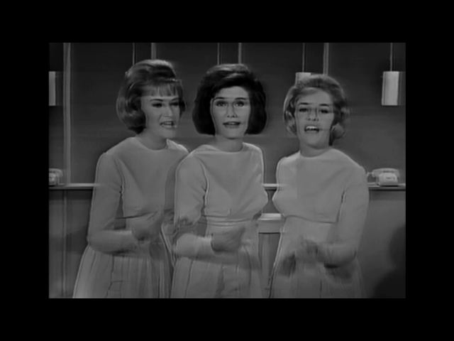

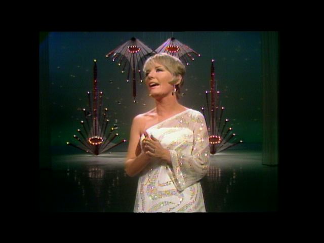

    What went wrong with this DVD? All video's have black bars around all four sides (see screenshots attached).
    Since the original films have an aspect ratio of 4:3, one would not expect black bars on top and bottom, only on the sides.
    Did the editors forgot to put a 4:3 flag?
    Some scenes on the DVD are originally 16:9. Those have black bars on the top and bottom.
ID:	21411Click image for larger version
ID:	21415Click image for larger version
ID:	21413Click image for larger version
ID:	21414Click image for larger version

  7. It's a 16:9 program letterboxed in a 4:3 stream. It looks like the SD output from many HD cable boxes.

    What happened here is the vintage footage was used within a 16:9 show by using Pillarboxing (bars to the left and right), and then the whole thing was letterboxed to a 4:3 frame and put on DVD like that.
    Not very clever:
    - It will give windowboxing on a 4:3 TV with the vintage footage (the modern footage will be letterboxed which is OK)
    - It will give windowboxing at all times on a 16:9 TV (unless you use 16:9 zoom, see below)
    With a 16:9 TV the right thing to do with any letterboxed 4:3 DVD or TV broadcast is to make use of the TV's 16:9 zoom (zoom != stretching). This will enlarge the picture, keeping the proportions, so that the horizontal borders of the encoded image on DVD will touch the sides on a 16:9 TV, cutting off the letterbox at the top and bottom. This will result in no black bars at all for the modern content and pillarboxing for the vintage footage.

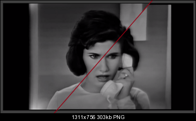

  18. What a mess. Even the PBS YouTube version looks better.

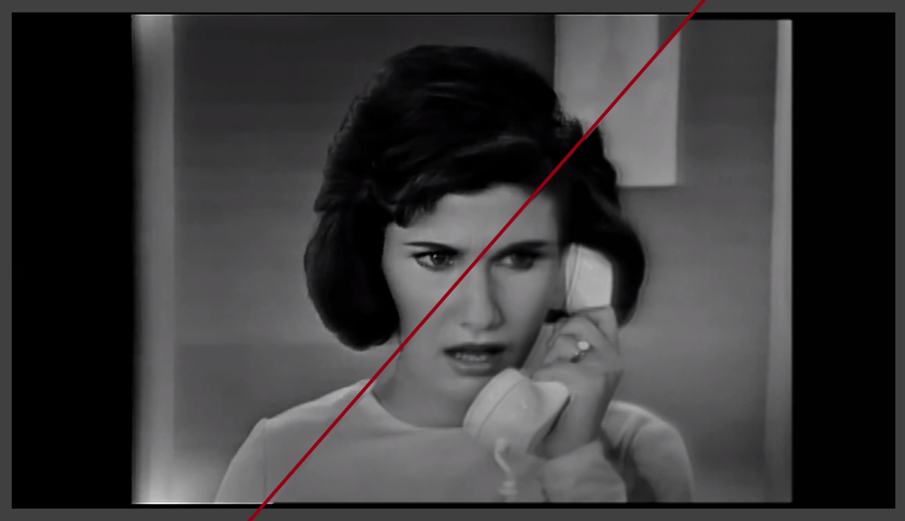

  21. On another note, a lot of companies will produce their 4:3 DVDs as widescreen by adding bars to the top and bottom. The only thing this really does is shrink the viewing area to be much smaller. Phantasm 1 and the original version of Halloween 3 on DVD both did this.

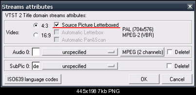

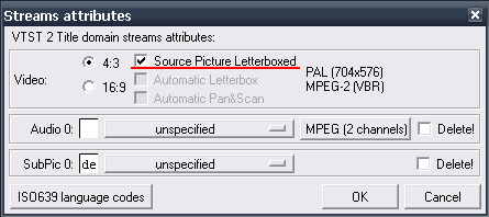

    Actually there is a flag in the IFOs which, if set, is supposed to tell the TV the picture is not full 4:3 but letterboxed. This would make a widescreen TV switch to it's 16:9 zoom automatically, avoiding windowboxing, without having to use the remote.
    The problem is, only few DVD-Players read this flag and tell the TV about it via the WSS signaling (that's how it's meant to be done).
    Also, there is no WSS signaling if one upscales the video before it reaches the TV – in such case it would suddenly become the player's task (instead of the TV) to zoom the picture but player manufacturers are pretty lazy in realizing this.
    And so, many people get windowboxing these days even if, ironically, the letterboxed flag was properly set on the DVD.
    Edit: That's the flag I'm talking about (in PgcEdit for example):
