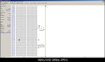

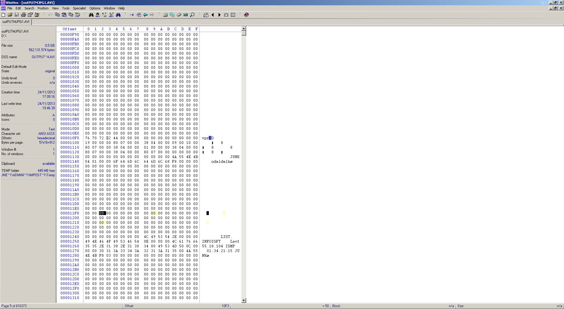

  9. I think you tried to figure it out already before ? ffmbc mjpeg imports, but ffmpeg mjpeg doesn't work ? But ffmbc mjpeg didn't say "interlace" for scan type ?
    Try running the AVI(s) through gspot . Sometimes there are AVI container differences that might cause something to not import
  10. my nle don't import nothing in mjpeg, using ffmbc or ffmpeg.
    import mjpeg files that are made with virtualdub, maybe I think is for the "interalced" but I don't know.
    Only when I set the project settings of Blade/Speed Razor to "rgb24" it comes able to read mjpeg .avi file from ffmpeg/ffmbc: the only differences between ffmbc and ffmpeg is that ffmpeg include a "vprp" which makes it difficult the playback and timecode read by the internal mjpeg decoder of Speed Razor/Blade: so I have modify the ffmpeg.exe with an hex editor, in "my" version of ffmpeg.exe it write .avi with a "vpr2" and not "vprp": this allow speed razor/blade to playback correctly .avi mjpeg file and reading timecode.
    But now my problem is another: if I set the project editing in 16bityuy2 or 16bituyvy the nle don't playback ffmpeg/ffmbc .avi files.
    I've not modify ffmbc, simply my speed razor don't playback mjpeg .avi files from ffmbc: simply ffmbc don't write "vprp" in .avi files but the problem remains.
