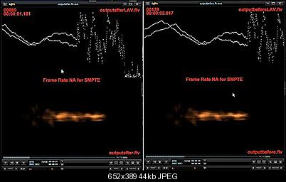

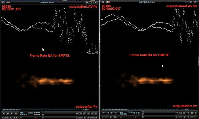

    Also try the -ss string before the -I file and after. See the below split with :
    ffmpeg -ss 00:00:04 -t 00:00:05 -i muzzleflash.flv vcodec copy -acodec copy muzzleflashbefore.flv
    and
    ffmpeg -i muzzleflash.flv -ss 00:00:04 -t 00:00:05 -vcodec copy -acodec copy muzzleflashafter.flv
    Note the Frame and time in upper left of each sample
    It makes a difference .
