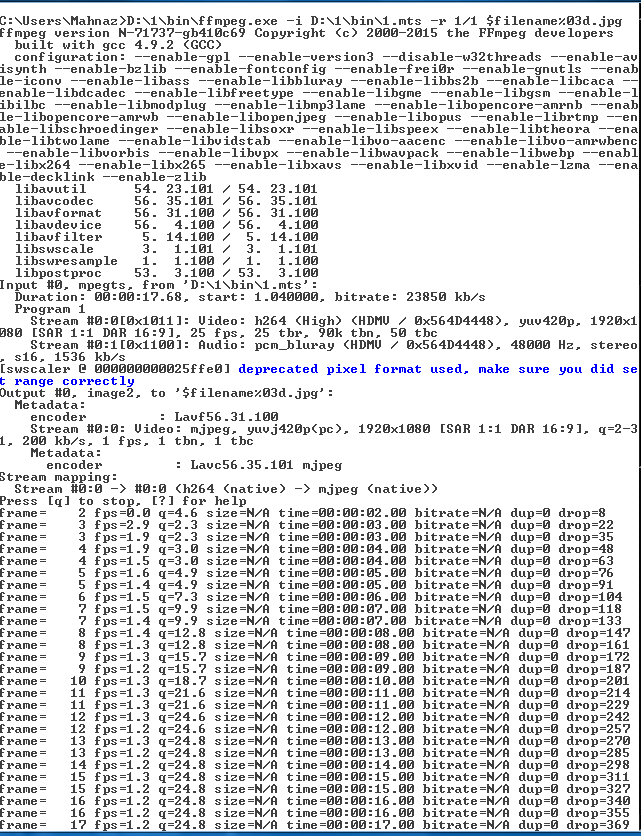

  1. Hi.
    Have a MTS file size 231 MB and length 02:32 minutes.
    I want to extract all frames from this file and save those as PNG files to a folder.
    The command I use is (runs from a bat file):
    D:\Multimedia\ffmpeg\bin\ffmpeg.exe -i 00025.MTS -r 1/1 $filename%03d.jpg
    Instead of extracting any images, I just get this console text:
    H:\Q>REM D:\Multimedia\ffmpeg\bin\ffmpeg.exe -i 00025.MTS -r 1/1 $filename"H:\Q\
    H:\Q>D:\Multimedia\ffmpeg\bin\ffmpeg.exe -i 00025.MTS -r 1/1 $filename"H:\Q\pext

  4. Code:
    Did you mean PNG or JPEG ?
  5. Member vhelp's Avatar
    Mar 2001
    New York
    there different ways of doing it.
    ffmpeg -i g:\1440x1080p.H264.m2ts -ss 00:00:00 -ss 00:00:04 -frames:v 24 -r 23.976 -y im_%4d.png
    the -ss is the seek method into the video. in the above example, i use two -ss commands. there are advantanges of when to use -ss. before the -i video and after. this affects the accuracy (between i-frames) and/or speed. for general extracting, i would say it doesn't matter. if you exclude the -ss (or -t which is the duration or length you want to extract) you will only get the first frame and no more.
    the %4d is the length of the padding for zeros sequentually, or else the sorting won't work correctly when opening/viewing the images in a folder or video timeline.
    the -frames:v n (n) is the how many frames you want to extract from that -ss position and onward, up to the end of the video. in the above example, i am extracting 24 frames, im_0001 im_0002 im_0003, ... im_0024.png
    if you add the .png at the end of the filename, ffmpeg will understand you want the .png format and convert to it automatically.

  8. Originally Posted by Prototype v1.0 View Post
    I think one problem is that "%4" in a bat file is threated as argument number four. It does omit from console output.
    As a commandline you need 1 % , as a batch file you need 2 %
    e.g
    for commandline
    for batch file

  29. Member
    Apr 2015
    tehran
    hi i have a damaged mts file form wedding that when play in vlc there is no picture and no sound
    how can i use this code for extracting some frames from video
    and repair
  30. Member
    Apr 2015
    tehran
    code:
