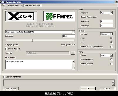

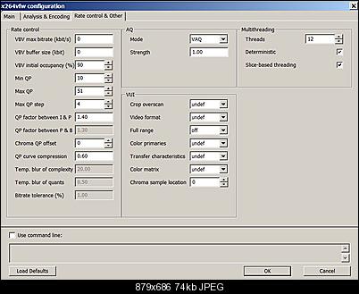

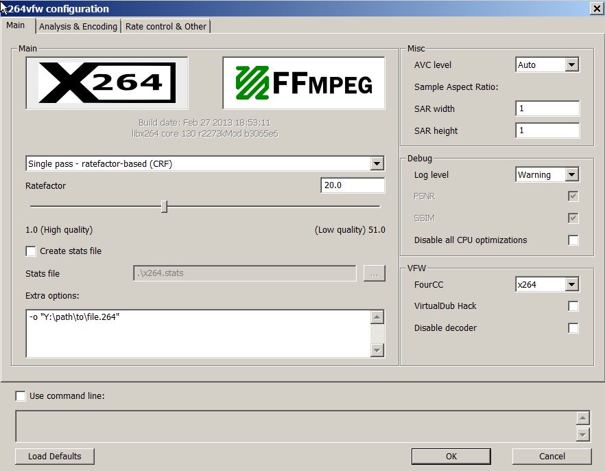

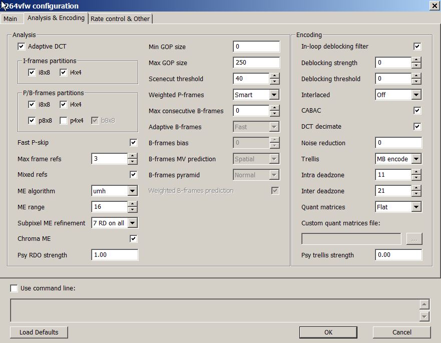

    The settings I use, do you see anything which could be improved ?
Name:	x264vfw configuration_2013-11-26_21-23-37.jpg
Name:	x264vfw configuration_2013-11-26_21-23-22.jpg
Name:	x264vfw configuration_2013-11-26_21-23-29.jpg
  9. There must be another problem. Are you sure you only get <50% in megui with equivalent settings? What are you feeding megui as input ? Maybe some other filters are bottleneck ?
    Those look almost like the equivalent to default "medium" settings in your screenshot .
    It will be slightly slower with x264vfw (it just is slightly slower, don't ask me why, maybe because of VFW, maybe some overhead)
    Are you sure you want to change them ? faster settings implies larger filesizes at the same "quality" level , or worse quality at similar filesizes . ie. "faster " settings are less compressed
