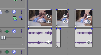

  13. Okay,
    Here's the latest. The two more recent clips are 48khz.
    (The original clip which I identified as 32khz I've examined more closely and it appears enosoft TRIED to import at 32khz and failed. The audio on that one is actually shorter than the video.)
    Bottom line, some of your clips are 48khz and some are 32.
