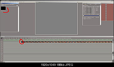

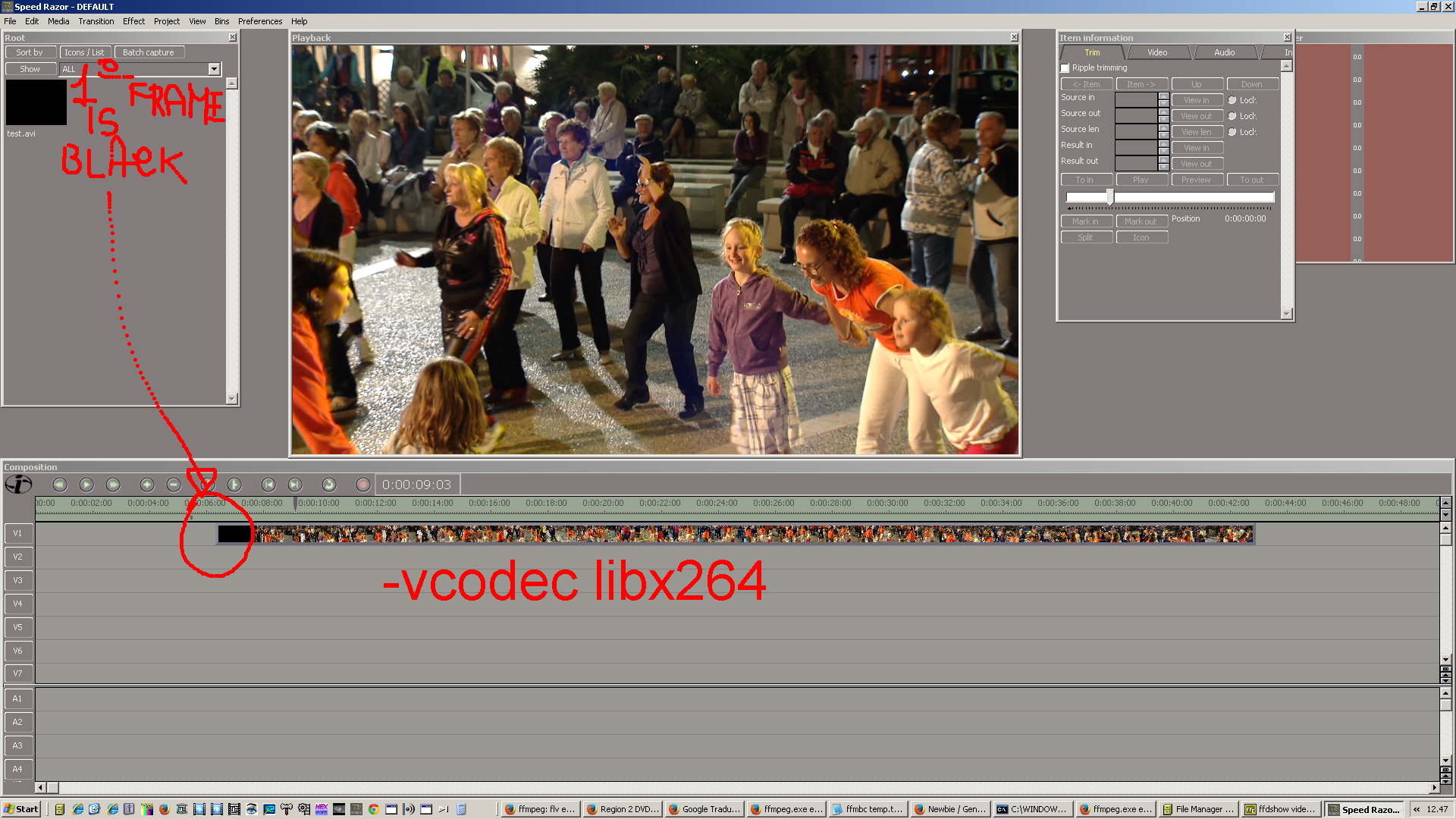

  13. Selur I thank you but using -vcodec lib264 don't help my specific problem:
    using
    ffmpeg.exe -i c0020.mxf -vcodec libx264 -pix_fmt yuv422p -preset veryfast -tune fastdecode -crf 0 -r 25.000 -flags +ildct+ilme -x264opts keyint=1:tff=1 -an x264_output.avi
    or
    ffmpeg -y -i "C0020.mxf" -pix_fmt yuv422p -an -vcodec libx264 -flags +ildct+ilme -x264opts tff=1 -crf 18 "test.flv"
    (but I'm costrincted to the .avi format output)
    or
    ffmpeg -y -i "C0020.mxf" -pix_fmt yuv422p -an -vcodec libx264 -flags +ildct+ilme -x264opts tff=1 -crf 18 "test.flv"ffmpeg -y -i "C0020.mxf" -pix_fmt yuv422p -an -vcodec libx264 -flags +ildct+ilme -x264opts tff=1 -crf 18 "test.avi"
    in all cases to use the libx264 (but also the use of -vcodec mpeg2video) I carry the same problem I have with MPG2 or using ffdshow VFW in my NLE (but virtualdub and all programs that take from VFW-ffdshow) the clip shows the first frame black and with difficulty seeking.
    The problem is related to ffdshow and in particular to the module VFW of ffdshow, in DirectShow all work ok.. but I'm forced to use VFW because my NLE uses only VFW.
    If you use your command line and the output in VirtualDub via VFW you can see the problem (first frame black and others).

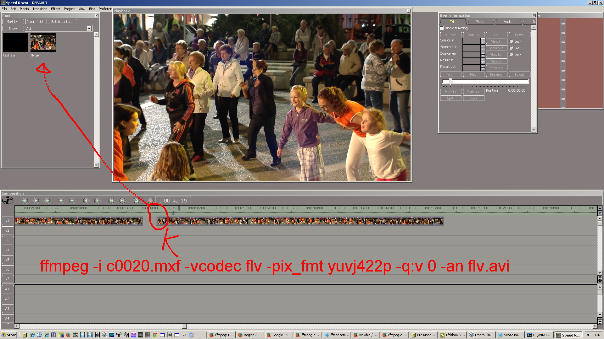

    May be strange but when I use
    ffmpeg -i c0020.mxf -vcodec flv -pix_fmt yuvj422p -q:v 0 -an flv.avi
    incredibly everything works fine inside my nle: first frame ok, seeking good, no deblocking... but ffmpeg returns that encode in 420

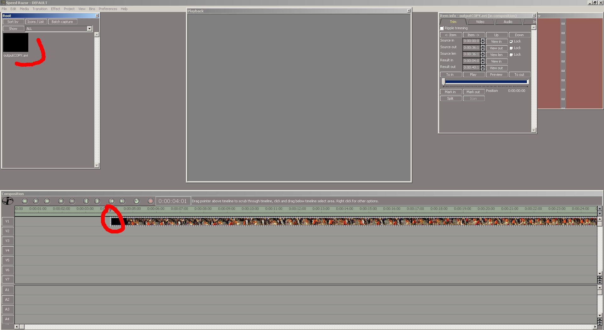

  15. the problem is in FFDSHOW that cannot decode well any formats in Vfw.
    Maybe there is a good way to encode in libx264 or I don't have use ffdshow but another decoder vfw for libx264.
    However I can not use flv, for various reasons, not least the fact that it does not work in 422.
    Much more simply: if I do
    ffmpeg -i c0020.mxf -vcodec copy -an outputCOPY.avi
    and use ffdshow with mpegINavi=libavcodec and set the registry vidc.mpg2=ff_vfw.dll
    I get exactly the same problem: first frame is black, deblocking (only on playback, export is ok), seeking a little difficult in backward ecc..
    it is strange that using -vcodec flv are solved all the problems except for the YUV422 encoding impossible
