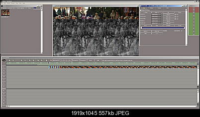

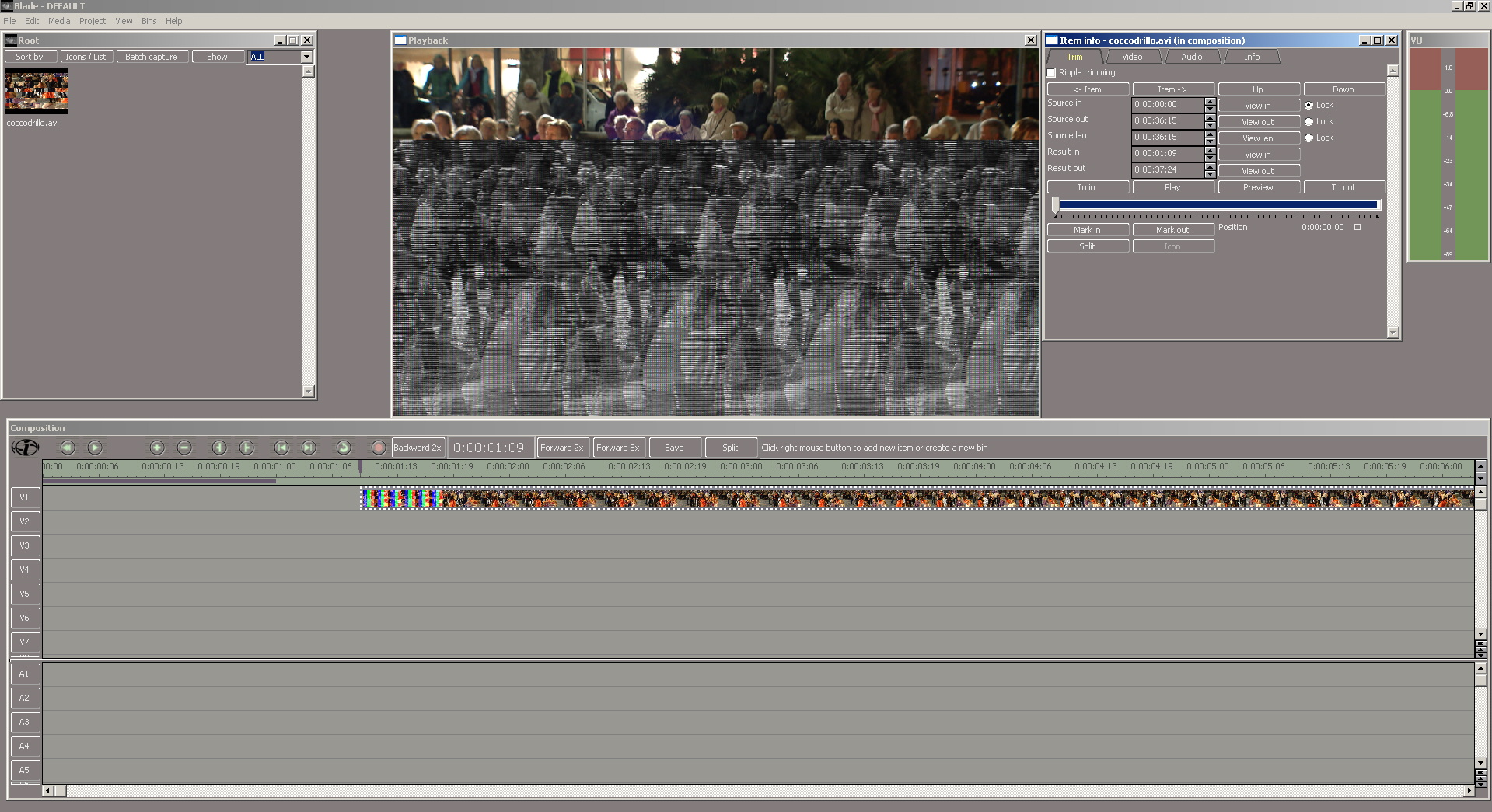

  3. Originally Posted by pandy View Post
    (or just use H.264 in single I lossless mode).
    so the encoding command line what should it be?
    However I use and old NLE (speed razor 5.51 or blade 2.2) that can not import natively mxf or mpeg2 files.

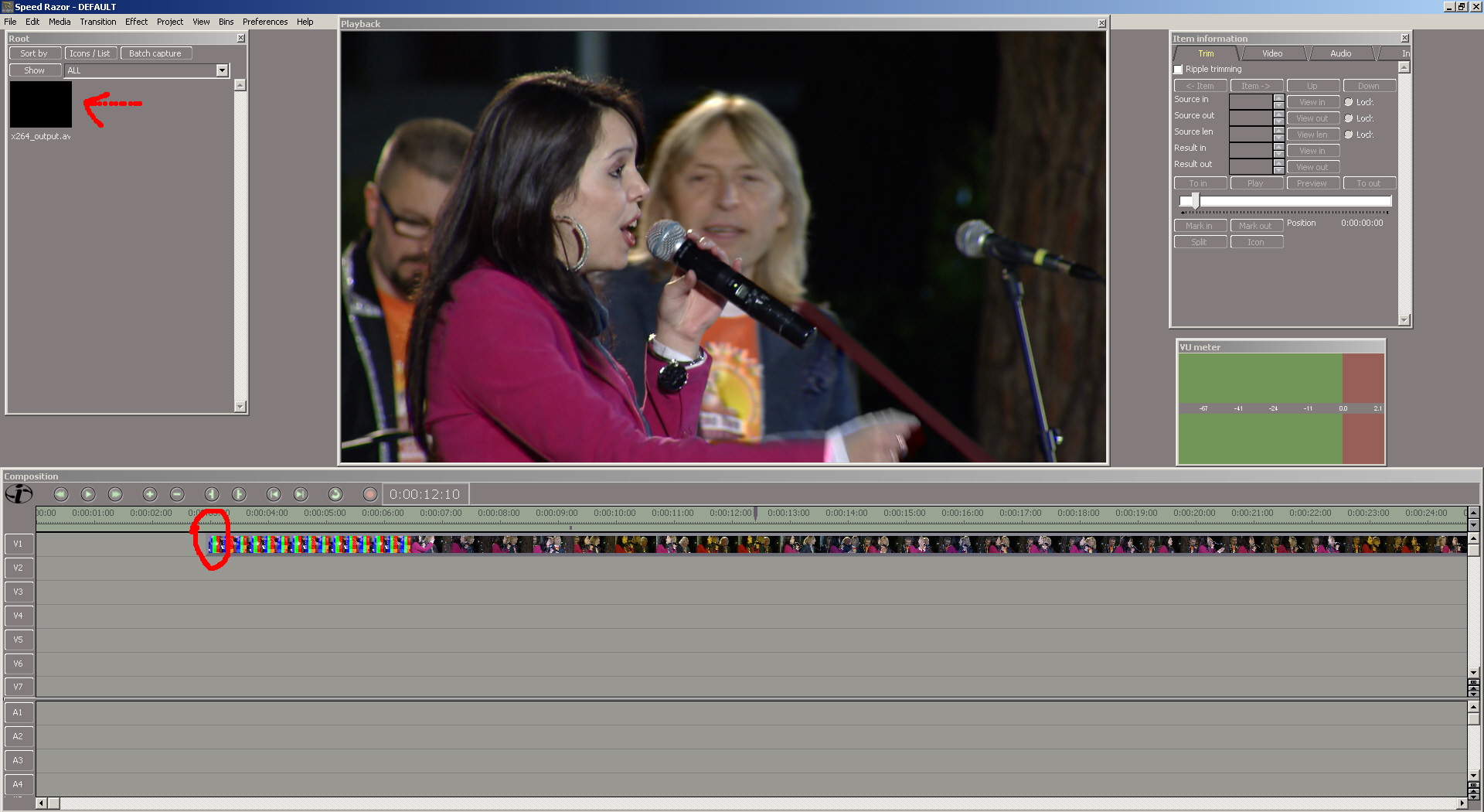

    It can import mxf and mpeg2 files via DirectShow but when I touch/scrub 15-20 clip it crashes because use too RAM, so I have to disable the directshow module "mediapostgeneric.rzf" of the nle. This way it can import only via VFW: for example I transcode the clip in mpeg2 or I can create an avi file using ffmpeg -vcodec copy that have default tag "mpg2", and do the association vidc.mpg2=ff_vfw.dll and installed FFdshow with "mpegINavi=libavcodec" and the nle import the clip but the first frame is black, and scrubbing shown deblocking and are not frame accurate (scrub1.jpg)
    Because of this I have to transcode in mjpeg, Speed Razor is working well in mjpeg but quality is a little lower.
    I would try to transcode in h.264 and use FFdshow as decoder but I don't know if it work well.

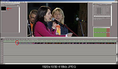

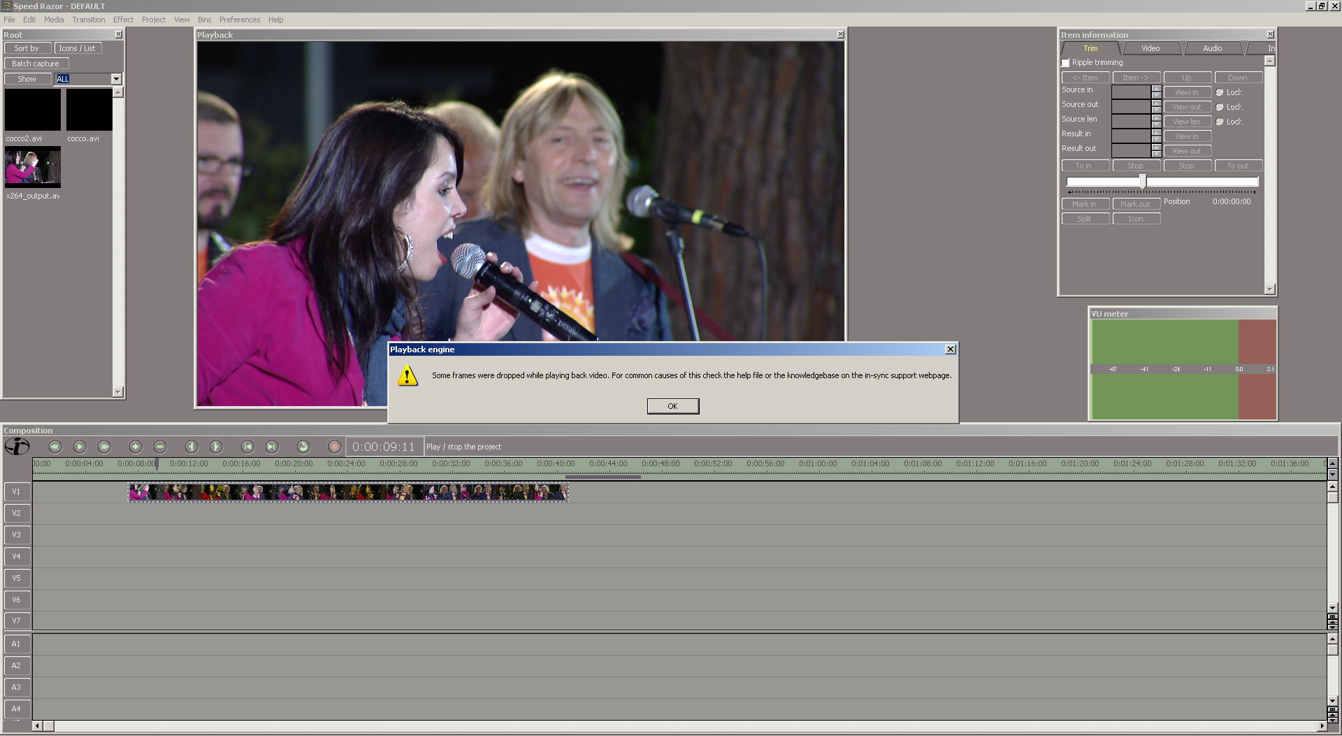

  7. in the meantime I have try to use ffdshow as decoder for h264 files imported in VFW in my nle butit seems that this type of codec is infected by the same disease that afflicts the mpeg2 files with the FFdshow: first frame black, seeking not accurate ecc...
    FFdshow don't manage correctly
  8. Try disabling h264/avc in ffdshow vfw decoder configuration, and use x264vfw (ffh264) as the decoder instead
    http://sourceforge.net/projects/x264vfw/
    It's time to use a modern NLE. It really is

    do it but: import seems ok, no first black frame but jerky playback

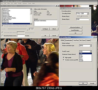

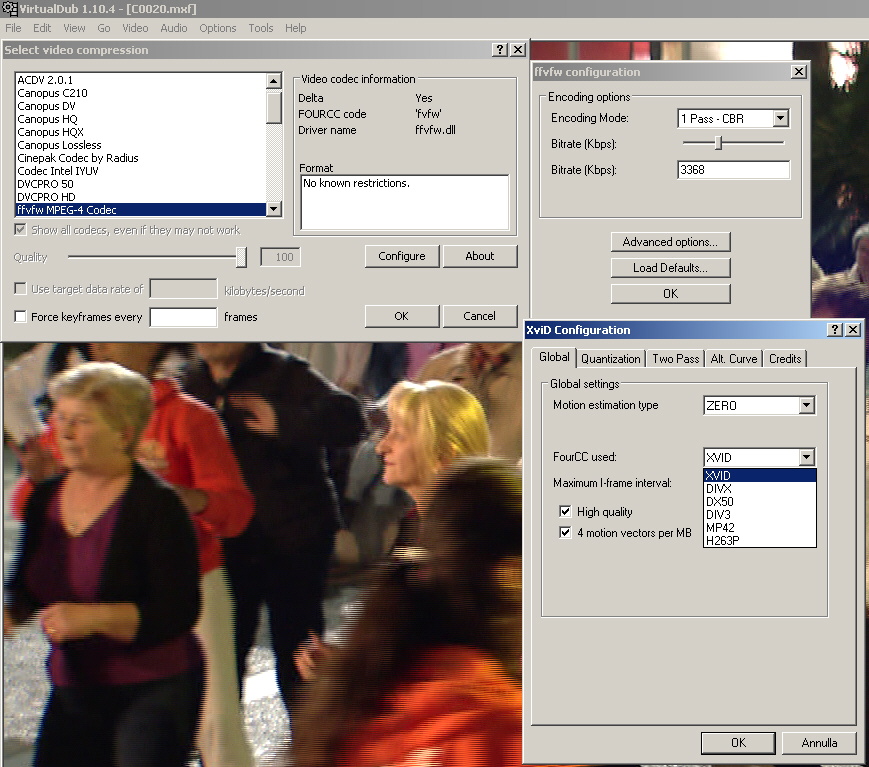

  10. Poison I have found on internet this attached codec:
    what is ffvfw.dll? it's not ff_vfw.dll of ffdshow
    to install it on the system ad vfw codec you should right clic on the ffvfw.inf file and select Install (if you-don'thave-winXP)
    can I configure it as a mpeg2 I frame codec? and use it for decoding?
    what is ffvfw.dll?
    I don' t know - it looks like a MPEG4 codec (probably ASP, like DivX, Xvid) . Probably not what you want, and only supports 4:2:0
