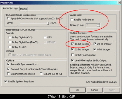

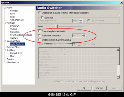

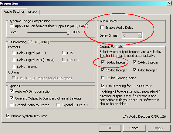

  12. Originally Posted by avz10 View Post
    I played it, using all 3 players, and the trend was the same: The audio and video started exactly at the same time when I played it with VLC and WMP, but there is a significant delay if I play it with Media Player Classic.
    What about other video, does MPC-HC introduce a similar delay? Specifically other AVIs?
    Not that the settings are likely to have changed by themselves, but I'd feel remiss if I didn't suggest you go into MPC-HC's options for a quick look-see.
    Under Internal Filters, and after clicking on the Audio decoder button:
    You might also want to try disabling all the output formats except 16 bit integer. You might have to restart MPC-HC for it to take effect. Admittedly those ideas are fairly improbable, but if you're correct and the audio is delayed when MPC-HC plays a file (and I'm not saying you're not) then something must be causing it.

    With regards to the video player settings, that is now fixed:
    Make sure you don't have
    MPC's audio time shift option set. View -> Options -> Internal Filters -> Audio Switcher -> Audio Time Shift.
    This was the case, so I have corrected it. Thanks! I also downloaded MPC-BE and the Auto Time Shift was also on. I corrected this.

    That's odd and odder... the fact that MPC-BE had an audio delay specified when you first installed it. I'm not sure, but it's possible MPC-HC and MPC-BE keep settings in the same place in the Windows registry, so if you change a setting in one it could change it for the other too. I'm not sure that's how it works, but both players have a setting in their options to "save settings to an ini file" which would mean changing a setting for one player should have no effect on the other.
    I'm glad it's sorted now. My oten used MPC-HC problem solver is the Reset button under Miscellaneous options. Use the Backup button first if you want to restore your settings. Resetting mightn't necessarily fix everything, but it fixes enough
