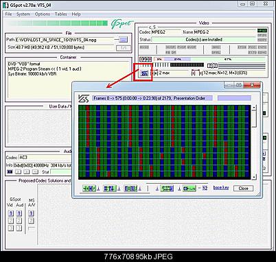

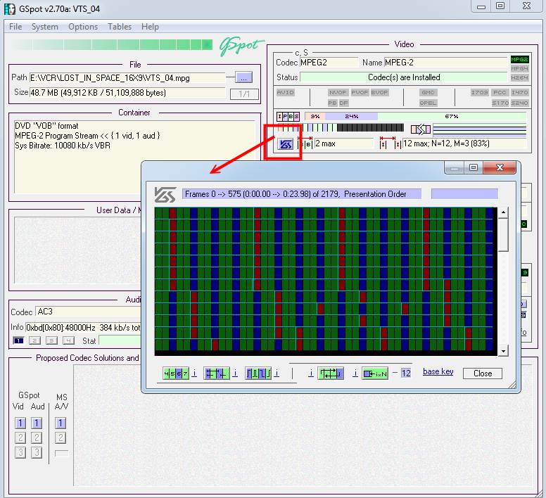

Hi all, anyone got any thoughts on a tool that will show the GOP structure of a MPEG2 file and or display stats on bits per frame, VBR/CBR, null packets etc....

In my case I'm doing some quality testing for a client, and I've been creating some test files to match as closely as I can the house video standards.
MPEG2 20mbps long GOP for SD playout is what I was told.
Anyway the GOP length I would expect is 12 (for pal) but the files I've been seeing are 18, this might be reducing playout quality just a tiny bit... I just needed a tool to prove it for my report.
