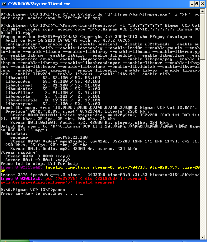

  5. There is another problem. Some conversion has problem and I didn't get full length of video. For example, 5 minute DAT but only 2 minute mpg. Is there parameter to fix the error. See attachment for detail.

  6. You've reached the limits of my knowledge of remuxing with ffmpeg!

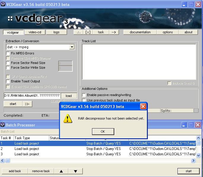

  10. What message error?
    I upload video how I tested
  11. Here it is

  13. Originally Posted by Rexkh View Post
    Here it is
    What version Winrar you have?
    The vcdgear using Winrar
  14. I'm sure all files are DAT. I'm using WinRAR 5 beta2. What does it has to do with WinRAR? It suppose to do conversion. Not compression.
    Could you please confirm that you did success doing batch conversion from DAT to MPEG-1 with VCDGear?
  15. Originally Posted by Rexkh View Post
    It probably keeps some utilities in a RAR file. It extracts those at runtime when necessary. I don't know why you even bother arguing about this when the program is telling exactly what's wrong.

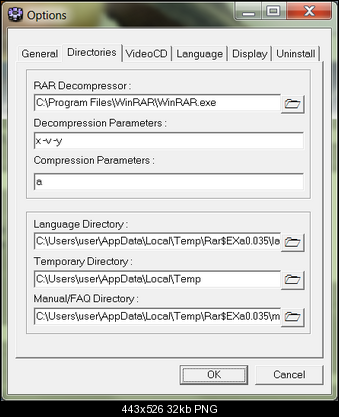

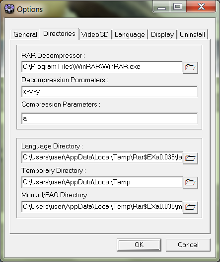

  16. Originally Posted by Rexkh View Post
    It does to do with WinRAR
    Please install WinRAR 4.20 and check VCDGear setting that directory of WinRAR correct then try again:

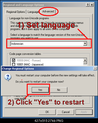

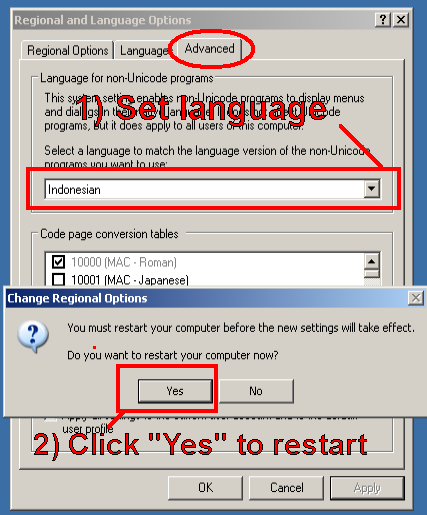

  21. What language DAT file name?
    I have no problem with non English characters
    You need set Windows XP (regional and language) options make software recognize non English characters
    By Control Panel -> Regional and language options -> Advanced:
