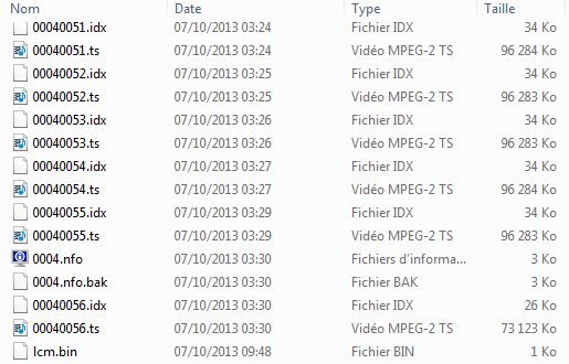

    Hi,
    My Box (LaBox Numericable, France) allows me to record HDTV on a hard disk (500Go).
    I would like to extract my recordings from this dik and convert them to divx. One hour of recording on the disk takes a huge space (~3Go).
    I tried to analyze the data that the system is storing on the disk. I describe below what I could understand.
    Could some one help me or guide me to where I could find information to join the audio and video stream.
    Thanks for your help.
    Here is what I have.
    The disk is a standard ext3 file system.

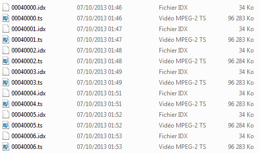

    Every recording is stored in a folder named '0000', '0001', '00002', '0003', ....
    (see pictures begin_0004_files.PNG and end_0004_files.PNG)
    An sqlite database (record.sq3) keeps track of movie title, channel name, recording ('000?')
    But where I have difficulties is to understand how the video and audio stream are organized.
    In a recording folder, approximately for every minute of recording, the system stores one "ts file" and one "idx file".
    These files have standard extension which do not correspond to the usual file type. idx is not a sub title file.

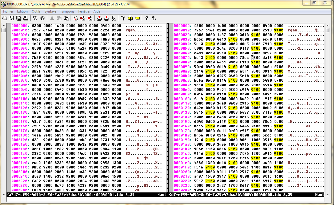

    I attached screen capture of two files (see begin_first_2_idx_files.PNG)

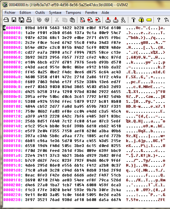

    See the 0004000_ts_first-lines.PNG for the first bytes of TS file.

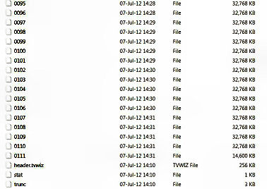

    It's a long shot but why don't you post the information on the Australian Beyonwiz PVR site. The recording format is similar inasmuch the recording is broken up into small chunks - no "idx" between them and it is fairly straight forward to join up the chunks into a standard mpegts file with either of 2 software programs, one supplied by the company and a much better one by a community member on the forum.
    http://www.beyonwiz.com.au/ The forum boasts a few programmers and technical savvy members so maybe you might get some pointers there.
    Here is a screen shot of part of a typical " .tvwiz " format
    Image Attached Images

    As I said in my initial mails, the first bytes are conserved in all idx files they may encode for the encoding of video/audio (21 bytes) :
    0200 0000 1c00 0000 0000 0000 0400 0000 7267 616e 02
    entering the following texte in google : "0x72 0x67 0x61 0x6e", I get some hints, one of them H264
    And entering "0x72 0x67 0x61 0x6e H264" I get source code files. Is it meaningfull?
    For the other values I show you the beginning and end of the data for the first 3 files(0004000.idx, 0004001.idx, 0004002.idx) the first value in <> seem to be the segmented data and the second <> is related to the time line (check first and last values between 2 successive files they are the same) and the number of lines in an idx file is very close to
    2880=24*60*2 and this is for one minute :
    00040000.idx
    1 : < 0>delta= 0 < 9507621>delta=9507621
    2 : < 14100>delta= 14100 < 9507638>delta= 17
    3 : < 48316>delta= 34216 < 9507662>delta= 24
    4 : < 82156>delta= 33840 < 9507678>delta= 16
    2891 : < 98468384>delta= 34216 < 9580194>delta= 23
    2892 : < 98502788>delta= 34404 < 9580219>delta= 25
    2893 : < 98536628>delta= 33840 < 9580242>delta= 23
    2894 : < 98570656>delta= 34028 < 9580242>delta= 0
    60*24*2=2880
    00040001.idx
    1 : < 0>delta= 0 < 9580242>delta=9580242
    2 : < 0>delta= 0 < 9580281>delta= 39
    3 : < 11268>delta= 11268 < 9580291>delta= 10
    4 : < 45296>delta= 34028 < 9580316>delta= 25
    2882 : < 98513680>delta= 34028 < 9652872>delta= 24
    2883 : < 98548084>delta= 34404 < 9652897>delta= 25
    2884 : < 98581924>delta= 33840 < 9652897>delta= 0
    00040002.idx
    1 : < 0>delta= 0 < 9652897>delta=9652897
    2 : < 0>delta= 0 < 9652967>delta= 70
    3 : < 22348>delta= 22348 < 9652968>delta= 1
    4 : < 56564>delta= 34216 < 9652976>delta= 8
    5 : < 90404>delta= 33840 < 9652991>delta= 15
    2875 : < 98438468>delta= 34028 < 9725473>delta= 16
    2876 : < 98472872>delta= 34404 < 9725501>delta= 28
    2877 : < 98506900>delta= 34028 < 9725521>delta= 20
    2878 : < 98540740>delta= 33840 < 9725544>delta= 23
    2879 : < 98574956>delta= 34216 < 9725544>delta= 0
