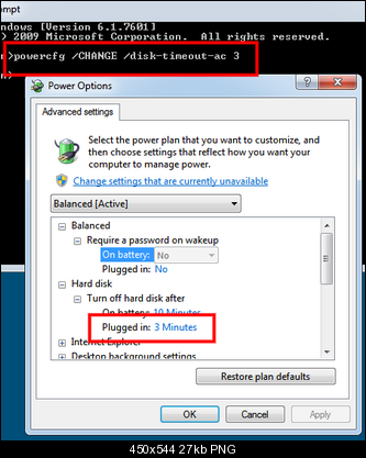

  9. Originally Posted by vhelp View Post
    i copy/pasted your code, still doesn't work, same error message.
    It worked here (Win7, 64 bit). I went to the power options via control panel and the disk timeout had changed to 3 minutes:
    this works, but does nothing for me:
    powercfg /SETACTIVE "Always On"
    Create another power plan (with different timeouts) and use /SETACTIVE to switch between them.
