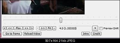

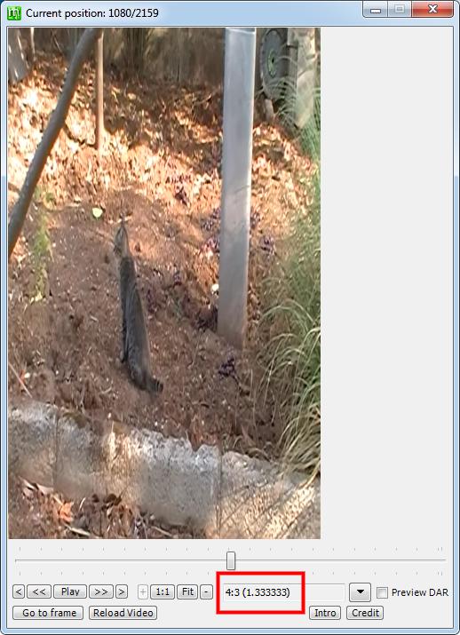

  5. I'd put it at the start of the script, just to be sure. Did the preview window show 4:3 DAR at the bottom?
    Note that some players may not respect the aspect ratio flagged in the header.

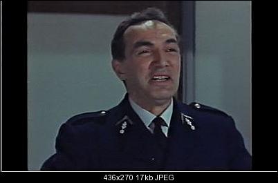

  6. Yes it does. I tried with vlc and pot player
    MediaInfo gives 0.651 aspect ratio for the MKV whereas it gives 4:3 for the initial vob.

  7. I wonder if some of the presets override the AR flag? I used "x264" Unrestricted 1pass Const. Quality Fast" when I tested it. Both MKV and MP4 output had 352x576 frame sizes with 4:3 DAR set in the header. MediaInfo showed the same. VLC and PotPlayer play both of them with the correct 4:3 DAR.

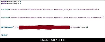

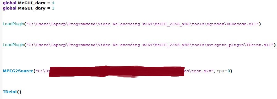

  8. Here is my script and the MeGUI settings:

  9. That's essentially the same as the script that I used. Try adding Info=3 to Mpeg2Source(), after CPU=0.
    It didn't work
    I even tried to do everything from the beginning, but still.....

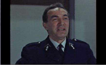

    Secondly, is there a way to remove (at conversion) the black bars that appear on the sides of the film when played in full screen, without a distorted outcome?
    [Attachment 21263 - Click to enlarge]
    No, not without distorting or cropping the frame.
