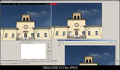

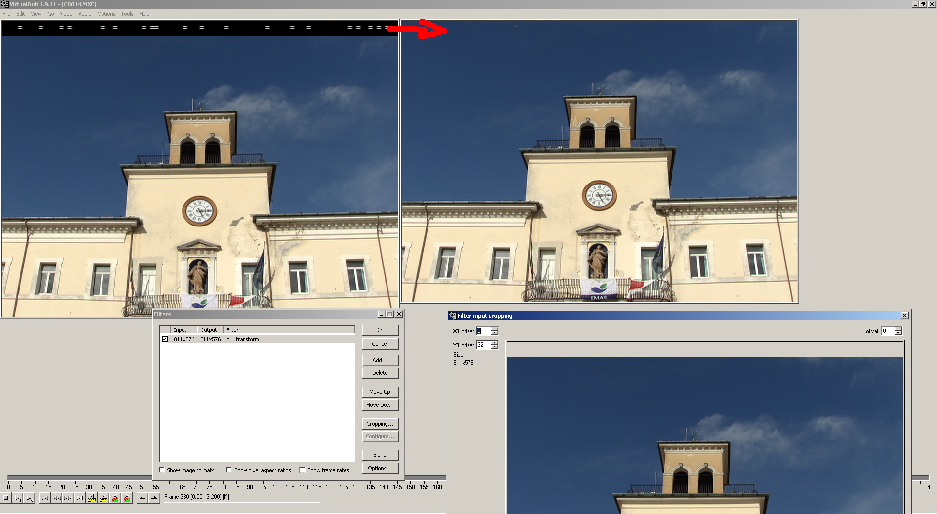

    because of my original .mxf files in SD mode have a signal VTC embedded when I transcode my files I have to crop the vitc lines on image cropping, in virtualdub the first 32 lines from the top
    if I would like do this in ffmpeg and mencoder what is the command line to crop 32 lines from the top?
