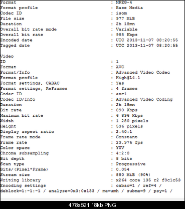

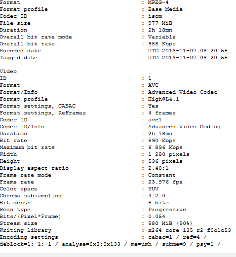

    Here is the info of the video file "before" conversion:

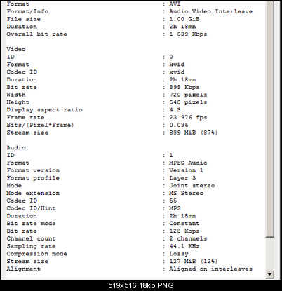

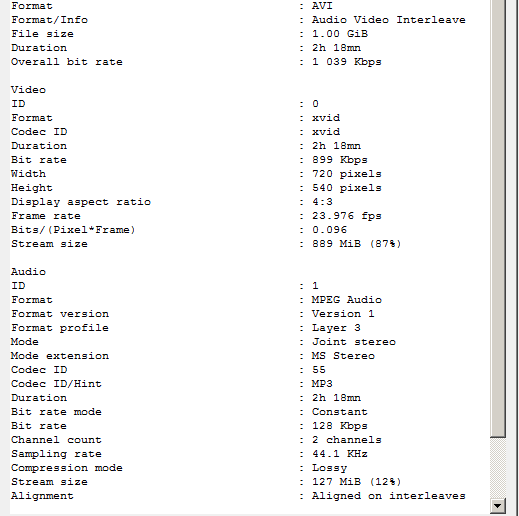

    Here is the info of the video file "after" conversion:

    I'm pretty sure my TV is 4:3 since its not rectangular so when i did the conversion, i selected 4:3. And made the resolution is 720x540.
    Now when i play the movie, it is narrow (like there are two black, blank empty spaces on the top and the bottom of the screen - i think you call them bars). There is no option to change the aspect ratio or zoom either on the TV settings or the DVD player settings. What did i do wrong? Why is the movie not filling my screen?? And most importantly...What can i do to play the movie on my TV at full screen???
    Appreciate any help guys!
    P.S. I used Aiseesoft Total Video Converter to convert the file.
  2. Because your movie is 2.4:1, not 4:3. If you want 4:3 you have to crop off the edges of the frame.
  3. You have a widescreen movie 2:40 ratio (Cinemascope, Panavision) Your TV is displaying the entire image correctly. Even on a widescreen TV (16:9) you would be seeing some bars on the top and bottom. The only way to fill the screen is to cut off the edges or squish the image.

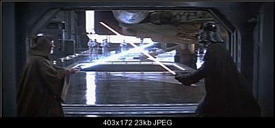

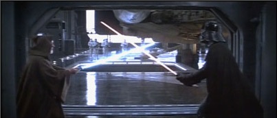

    You can watch it like it was filmed,
    And have black bars on the top and bottom,

    Good post,this one should be a sticky for people who keep asking how to get a full screen on their 4:3 tv with wide screen videos.
