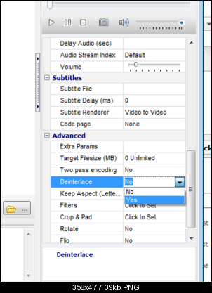

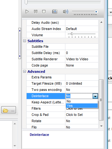

  6. Change the deinterlacing option from no to yes. Done.

  9. Ok, I tried "deinterlace=yes". Convertion stops with error:
    #2140.0: Access violation at address 6252A4D7 in module 'avfilter-3.dll'. Read of address 00000000
    ERROR: Access violation at address 6252A4D7 in module 'avfilter-3.dll'. Read of address 00000000...
