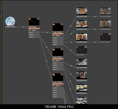

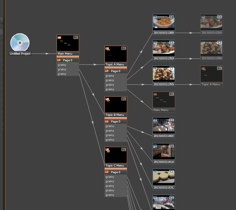

    DVD sample structure:

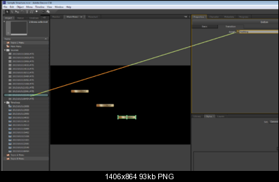

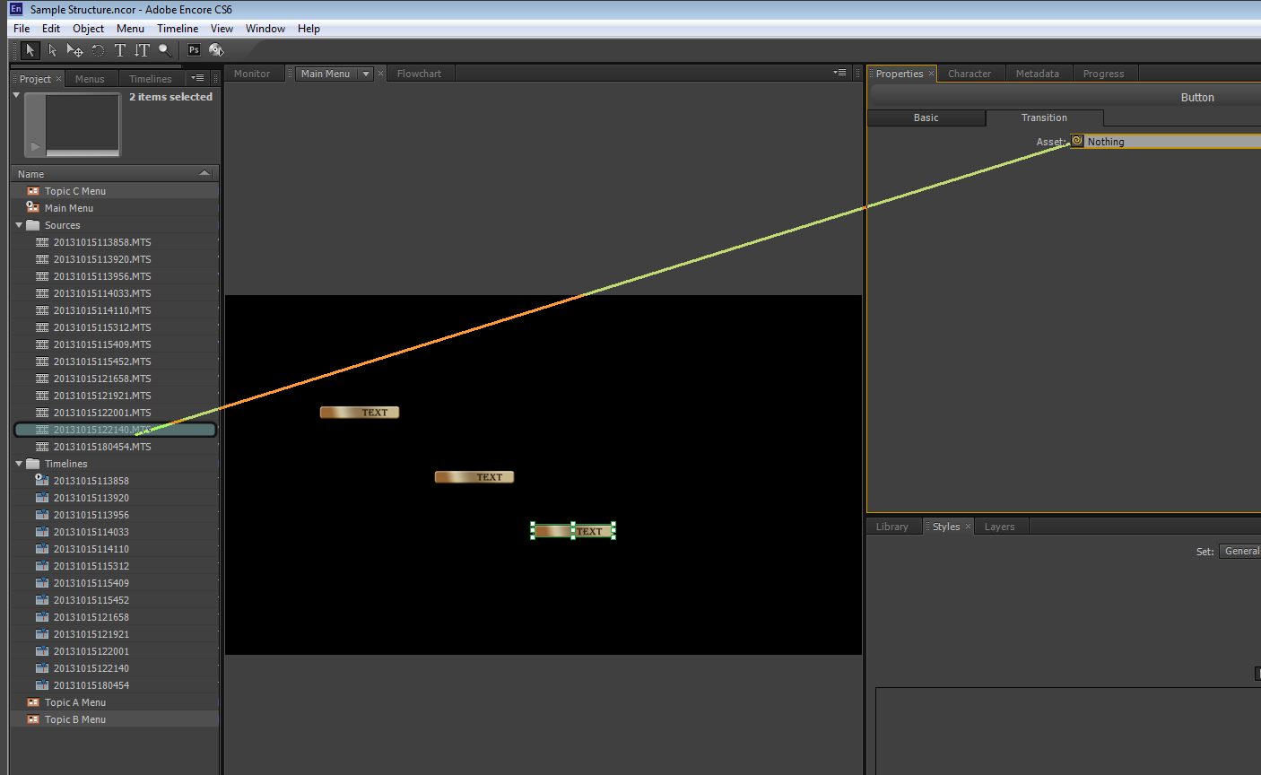

    Defining a transitional animation is as simple as drawing a line to it from the menu button properties. But you have to create the transitional clip yourself in After Effects (or others) as noted earlier.

  14. I find it helps to plan it out on paper (yes, there is still such a thing LOL) , so you have the order, how menus , timelines and end actions link up. I find planning ahead of time will save lots of headache later
    Personally, I would redo this project from scratch in encore - but you should be able to save some of the assets like animations for use in encore
    But there might be a way to do this easily (just replace the static menus with animated motion menus) with various reauthoring software. There are some huge comprehensive guides on this site, but it's beyond my level of knowledge
