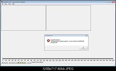

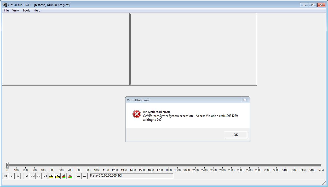

  21. Is it just me or does the ScriptClip() segment cause a crash after a while? I can see memory usage increasing until the process (x264 CLI encoder) has eaten up 3.5 GB of memory (about 550 frames into a 1280x720 source video, even with SetMemoryMax(1000) or less) then the process crashes. Maybe this problem is limited to the multithreaded AviSynth? ScriptClip() doesn't work at all if I use SetMtMode(2,n).
  22. Member
    Nov 2013
    India
    Happening to me also. I switched to xvid and now the crash happens near the end.
    Here is my script

  28. No, the ScriptClip() memory leak problem isn't caused by Reverse(). Though that may exacerbate it.
  29. Member
    Nov 2013
    India
    I removed Reverse as well as Smoothdeinterlace and it still crashes. So its a memory leak in scriptclip
  30. Yes, as mentioned above, there is a known memory leak with scriptclip . Gavino found this with srestore a few years back and re-wrote the function
    http://forum.doom9.org/showthread.php?p=1325921#post1325921
    Apparently there is a way to write the functions differently to reduce the leak, but it' s WAY above my head . That's why I suggested to PM him . You can read from this post and the next few ones
    http://forum.doom9.org/showthread.php?p=1652758#post1652758
    Breaking out the script into smaller sections will reduce memory related issues. (Using more memory , or more filters, more functions won't help and will certainly make it worse)
    For example, can you render only that 129 frame section with scriptclip separately into a lossless intermediate without crashing ? Use SetMemoryMax(512), use "vanilla" avisynth , not MT . Batch resize the clips beforehand instead of using Lanczos in the script . IMO - having it successfully render at slowly at 0.5 fps is better than not at all ; or having some crash
    If not, then you might have to use another method or use an AE trial version like smrpix suggested
