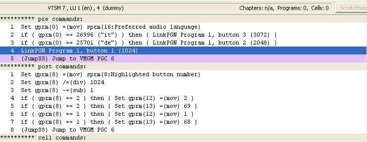

  3. I thought it was that PGC because the program seems to stop at pre-com 5 (see picture), anyway you know better than me.
    I suppose you have converted the PGC to dummy somehow
    I didn't do anything, this is the output straight out from DVDFab.
    (BTW, these DVDs are full of dummy... stuff I don't understand what's for, but that's another story)
    Use Info -> Find Jumps to Nowhere to locate this kind of error in the whole DVD.
    That returned: none.
    If that PGC has buttons, you should keep it (or, if you are sure the menu is useless, you can skip it with PgcEdit's Kill PGC Playback
    It's a dummy, so it hasn't buttons (and there's no playback to kill).

    I created a cell into VTSM 7 and now it seems to work. Have to test it more accurately.
    Could be this a way to fix the problem?

  4. Yes, it could be. That PGC is (was) obviously the audio language selection menu, and replacing a cell has the effect to skip it. I can't tell you how the DVD will react with a menu that has been butchered like this, as of course the user cannot select the right button any more. As far as I can tell without seeing the original button commands, when the nav is what I've read in your trace, it seems that it will react as if the user had selected the default language (probably English). IMO, you can even simplify it more, and remove most of the pre-commands. The two conditional linkPGN in line 2 and 3 should be removed, as they can lead to other problems. Also, pre-command 5 is dead. (It cannot be executed.) I think someone or DVDFab has tried to skip that menu by jumping straight to VMGM PGC 6, but there is a severe bug, and the other pre-commands are executed instead. You can even try to remove all commands but pre-command 5, and I guess it will work almost normally (without the audio menu, definitely lost). If you leave only the jump, you can also remove the cell.
    That PGC has certainly not been authored that way on the original DVD. So, either it has been badly skipped by DVDFab (and I wonder why DVDFab has decided to skip it), or the DVD has been badly modified by an human who has tried to remove all audio languages but one, and the audio selection menu. Anyway it's not the original commercial DVD, as as it is, it crashes certainly on most players.
