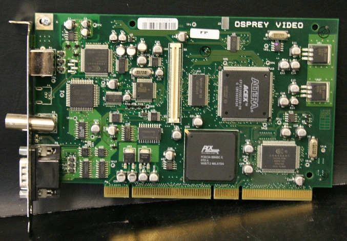

    So I bought this Osprey 530 PCI-X card to capture 720x486 SDI.
    The website says it's compatible with a regular PCI slot, and I looked up the various forms of PCI/PCI-X on Wikipedia to confirm as well. It seems that the right-most connector should just hang there unused while the rest plug in for a PCI slot.

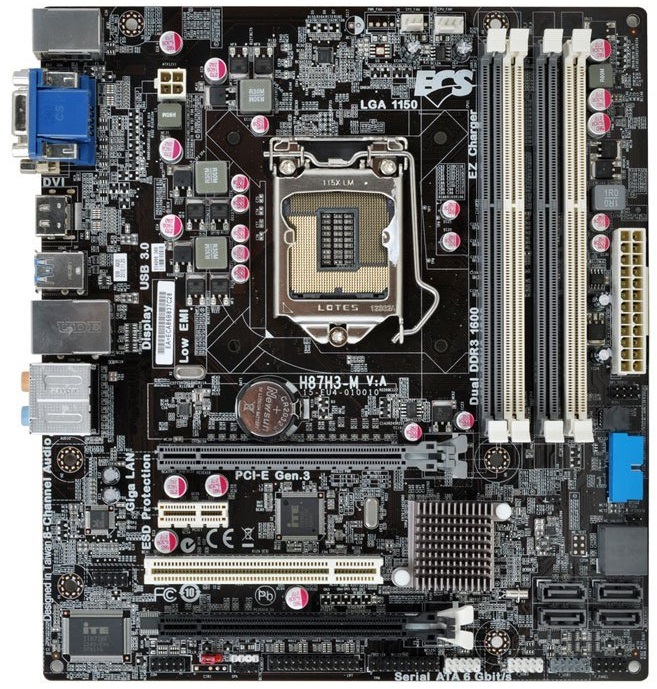

    What I didn't consider until I was down attempting to shove it in, is the layout of my motherboard.
Name:	ECS Elitegroup Micro ATX H87H3-M mobo.jpg
    The useless connector I'm wishing I could chop off is blocked by a heatsink.
  2. You're gonna need a riser.
    Maybe something like this: http://www.circotech.com/1u-1-x-32bit-5v-pci-with-7cm-flex-cable-right-angle.html?gcli...FW_NOgodPCcACg
    And a little ingenuity in how to mount it.
    Aug 2006
    If there is a half-height slot cover for the card maybe a PCI-e to PCI adapter would let you use a PCI-e slot that isn't blocked http://www.newegg.com/Product/Product.aspx?Item=N82E16815158165
    http://www.startech.com/Cards-Adapters/Slot-Extension/PCI-Express-to-PCI-Adapter-Card~PEX1PCI1
    Other than this problem, how do you like that motherboard? I'm thinking of buying one for a new build.

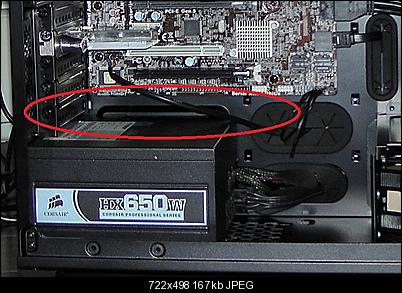

    Hmm, interesting. If they make a riser like the first one with a longer cable, could I screw the card into the empty spot below the motherboard?
Name:	2013-09-07 PC build - highlight.jpg
    The card itself is full-height so I don't understand the half-height suggestion.

  5. Take some needle-nose pliers and/or a flat-blade screwdriver and bend the bejeezus out of the fins on the heatsink, you may be able to get enough clearance that way. If the sides are solid, use a hacksaw after removing the sink from the mobo.
  6. Anonymous
    Guest
    Another more drastic way is to chop off the extended piece very carfuly. Try to cut of just as much as needed to clear the card from the heatsink. It's not very likely that you ever gonna use that anyway, but your warranty will be expired!
    removing the heatsink from the motherboard and cut it would be my last option.
    A risercard would be the best solution but i think you need to fabricate a mounting bracket yourself and make sure it all fit's in your computer case.
    That's the safest thing to do. Even if you cut off the connector it would still hit the heatsink, you can't cut into the green part there may be hidden copper lines between the PCB layers.
    If you were to cut the heatsink, you should remove it, but keep in mind that the engineers chose it for a specific thermal dissipation. Before you re-install it, you have to clean off the old thermal compound and apply new one. If you fiddled with the heatsink and now it's sitting loosely on top of the chip, the thermal interface is broken and the heatsink should be removed and re-installed.
    This riser cable is 6" long that should be more than enough to reach that empty slot. Keep in mind the video connection doesn't have to be outside the case, you can always run a video cable out of the case.

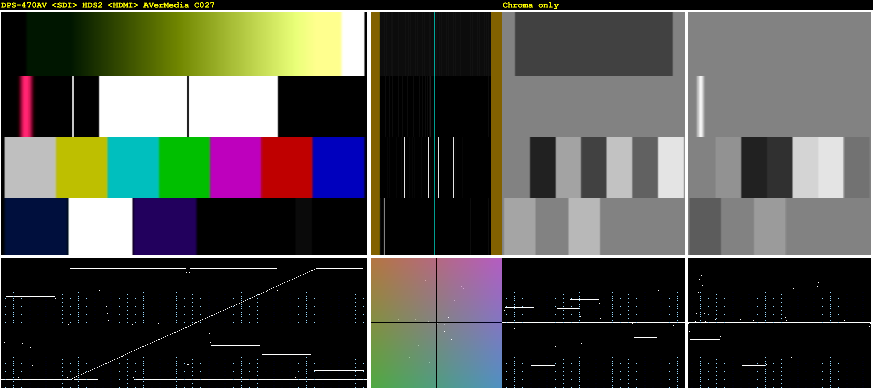

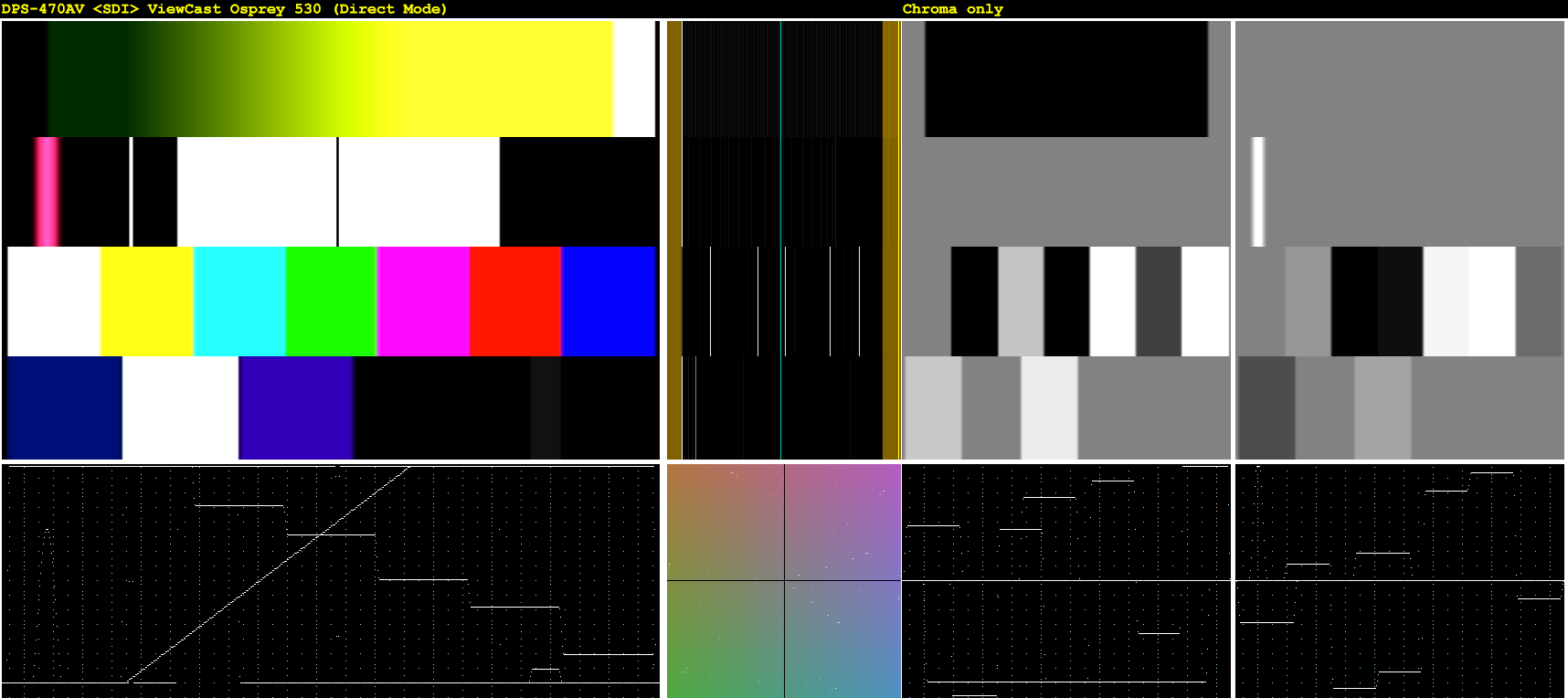

    Back to the thread topic, a few days ago it struck me that I may as well try the card in the old computer in the closet that I was using prior to this new build. Two of the PCI slots on that board are similarly blocked by a heatsink, but the bottom two have a wide area available.
    Unfortunately it looks like I needn't bother trying to get it working with the new PC. Aside from the acceptable 8-bit limitation, in "Direct Mode" the contrast and saturation are insanely boosted.
ID:	21287 Click image for larger version
    With Post Processing turned on and the Proc Amp at defaults, the levels are still wrong. I'm reminded of all the troubles people have trying to capture bit-perfect digital audio on Windows.
