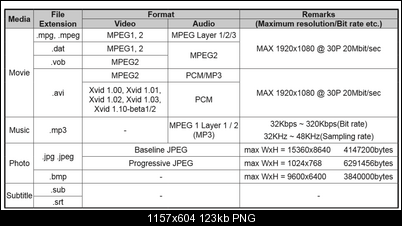

    I don't understand what i should be converting a movie to. i have tried .avi, .mpeg2, .mpeg, divx i have used Xilisoft Video Converter Ultimate, Divx converter 10 and winavi, some work and some don't. just wondering if someone can explain what i am doing wrong.
    Thanks in advance.
    Jamie

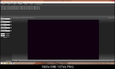

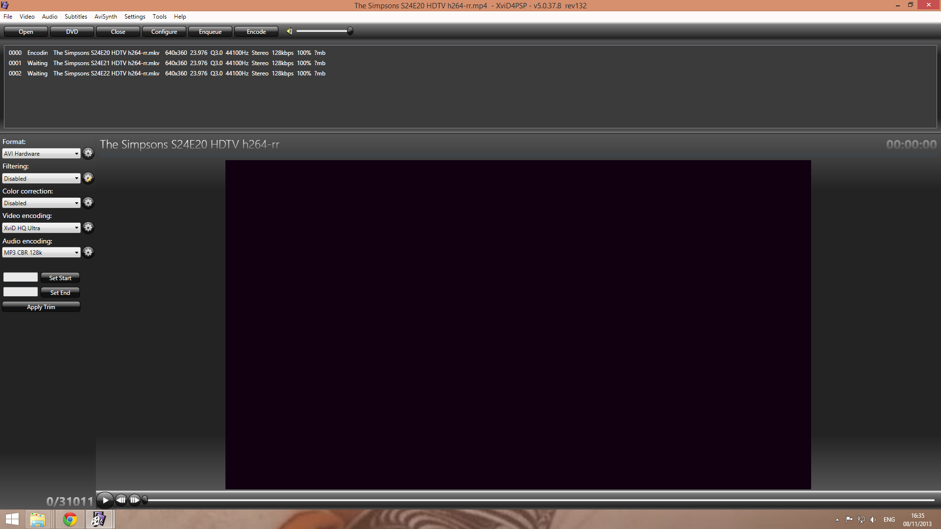

  3. sorry to be silly but this profile? new to this lol.

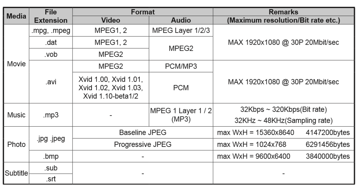

  6. All you have to do is match the video and audio encoding format from the list with that of the software you're using, and disregard the resolution in the remarks. So, with the profile your showing Xvid HQ and MP3 CBR don't match the list i.e. Xvid HQ is not Xvid and MP3 is not PCM.
    I have serious doubts about PCM only in AVI, everything else plays MP3. Just use AutoGK to convert and you'll be done. Choose ESS standalone player when asked and set the quality to 75%
