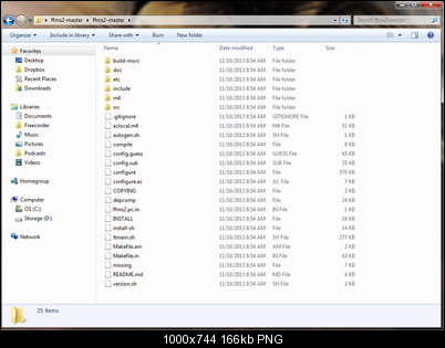

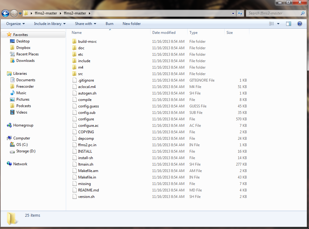

    I'm stuck on step 2. After unzipping, I see no .dll or .avsi files.

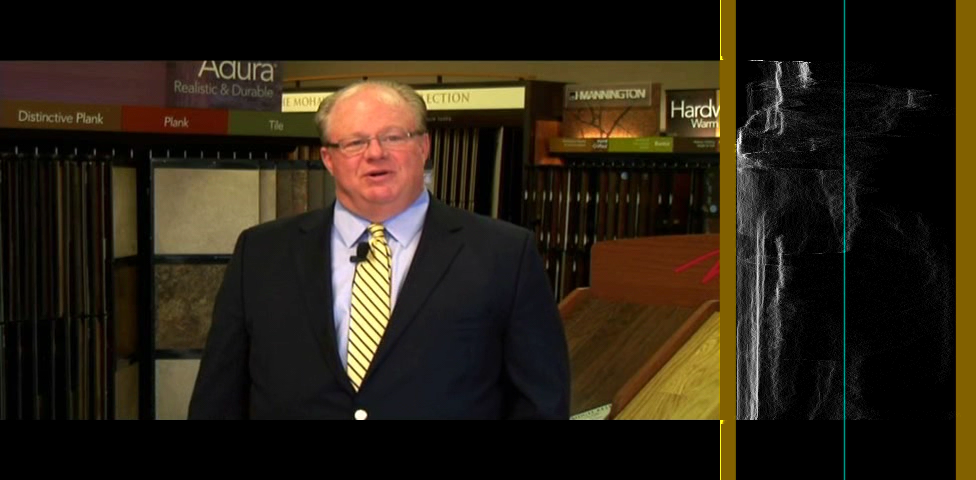

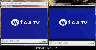

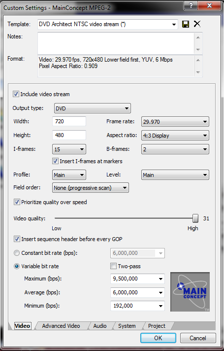

  14. Something wrong with your last file, it seems more blurry than it should be
    View these at 1:1 and compare the text in the background and the various fine details like textures, wood grain etc.... Was that "Melodious - Tom 4-3.mpg" a direct export, or did you do something else to it ?
    The circled area on the histogram (actually a Y' waveform) shows where the black level difference is . The black level difference isn't show in the screenshot (only picked up by the histogram), because of the standard Rec601 conversion for RGB
    This is actually a B-frame on my encode, compared with a P-frame on yours . (P-frames are usually higher quality and allocated more bitrate). And the average bitrate for the entire file was lower on my version. Vegas9 export
    Ok,that's not a compiled version that you downloaded
    Try this one here
    http://code.google.com/p/ffmpegsource/downloads/detail?name=ffms-2.17.7z
    The one I'm using is here , with avisynth 2.6 alpha 5
    http://forum.doom9.org/showthread.php?p=1650386#post1650386

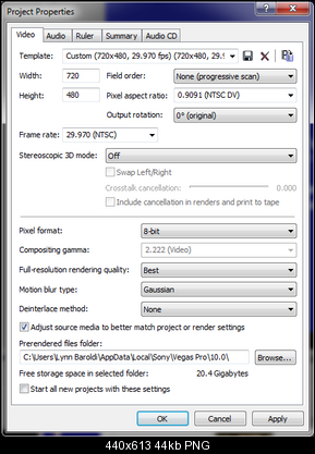

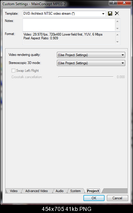

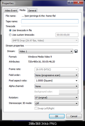

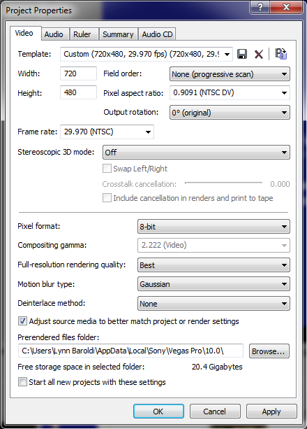

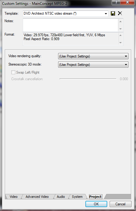

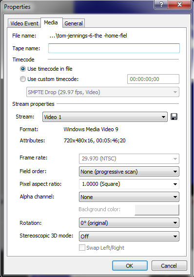

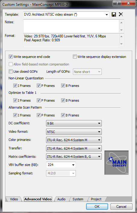

    I see the difference. Mine is much blurrier. And yes, it is a direct export from Vegas. Here were all the settings for my export:

    1) Install avisynth
    2) Download ffms plugin package , unzip and place the .dll, and .avsi into the avisynth/plugins directory
    3) Open a text file with notepad write the following , save it, change the extension from .txt to .avs . You would change the PATH to whatever the path is, e.g. C:\folder etc... . And the filename to whatever the wmv file name is

  26. [QUOTE=poisondeathray;2281893]
    Originally Posted by Melodious View Post
    What kind of things/edits/manipulations are you doing in vegas ? For some projects it might be easier to do in avisynth alone (what do you specifically need vegas for on this project ? )

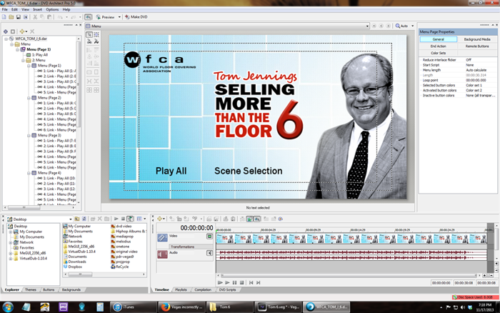

    One adjustment I'm making is using a color corrector to take the "red" out of Tom's face. The person in charge of the project specifically requested that. I had to do this for last year's DVD and she was happy with the results. I'm also inserting chapter markers into the timeline and titling them so that when the MPEG-2 is inserted into DVD Architect, the chapters will be prearranged. Does DVD Architect use a bad recompressor? It's the only DVD authoring program I have and know how to use. This is my menu screen:

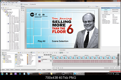

  27. Originally Posted by poisondeathray View Post
    The only thing that's bugging me is it looks horizontally stretched just a tad. Or maybe that's how the source looks. Tell me what you think. This is a Vegas MPEG-2 render of the VirtualDub AVI:
    https://dl.dropboxusercontent.com/u/26626325/Melodious%20-%20Tom%204-3%20Avisynth.mpg
    I haven't looked at this yet, but remember vegas uses ITU guidelines for resizing and AR. So if you export a MPEG2 for DVD directly, it won't necessarily look the same as encoding that script directly with something like hcenc , cce or some other encoder that accepts avs scripts natively
    Also, when importing intermediate AVI files into vegas, you have to go through the same hoops with AR interpreting

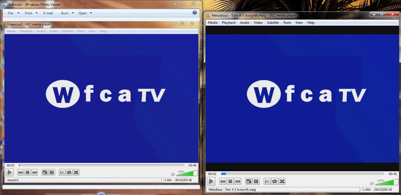

    I don't know man. Here's a side by side of the original video played in its original size (left) and the vegas mpeg-2 render of the avisynth avi (right).
    Looks about the same to me.
