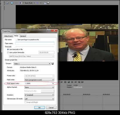

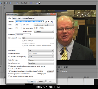

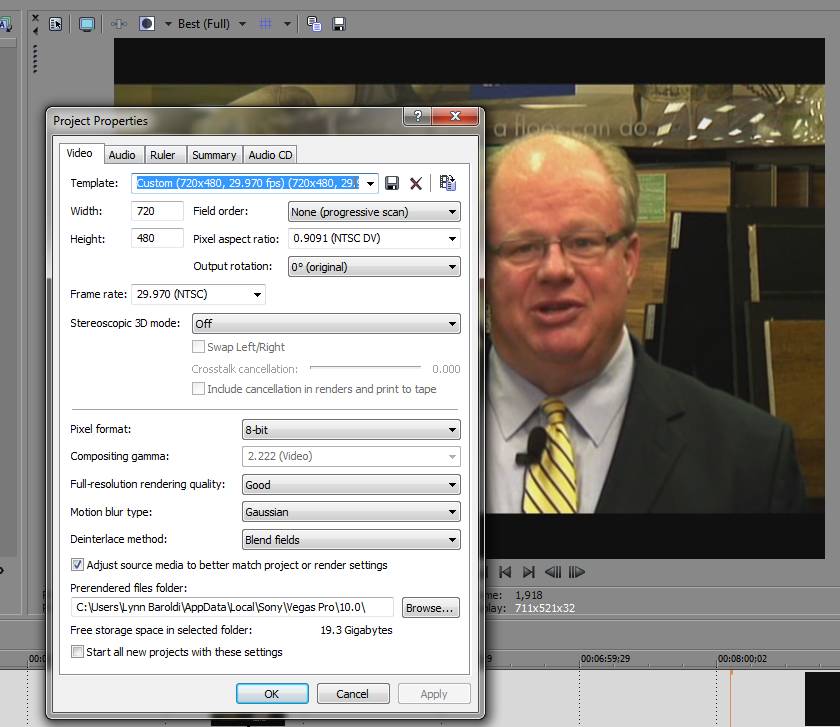

  1. I'm in a time crunch here with $1000 on the line.
    A printing press owner (who's related to a friend of mine) asked me to create a training DVD for a carpet company. (This is something I've done for them each year for the past 5 years). I've had no issues in the past, but this time there's a weird problem.
    The videos I were provided with have an aspect ratio that I can't for the life of me figure out. Normally I'm provided with true widescreen DV videos (720x480). However, when I playback the WMVs they gave me, it seems like there are thin black bars on the sides of the videos. It's neither 4:3 nor 16:9.
    When I drop it into Vegas and make the project properties match the media settings, this is what comes up:
    Consequently, the black bars on the sides become thicker (it thinks that it's a NTSC DV). Even though when you play the original video, the video is much wider than NTSC DV: https://dl.dropboxusercontent.com/u/26626325/tom-jennings-6-the%20-home-field-advantage-546.wmv
    Can anyone tell me why this video is getting squashed in Vegas and how to just process it in its native aspect ratio, height and width?
    I asked the owner to ask them for new video files with proper widescreen dimensions, but they're being stingy about it. They expect me to use what I have and get them organized onto a DVD the exact way they are.
    Help.

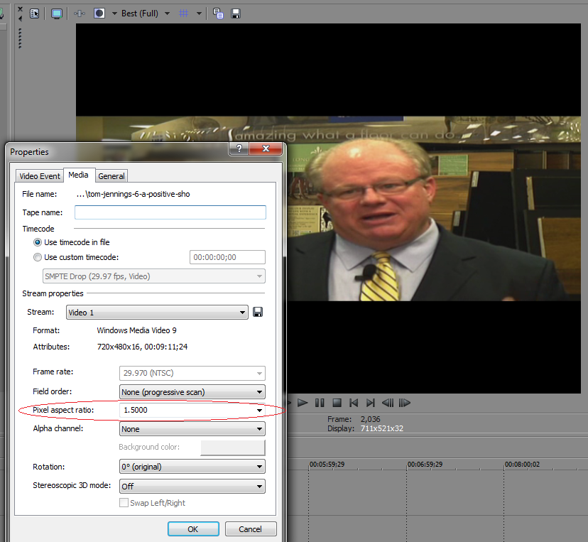

    I tried opening the source properties as you said. It allows me to change the pixel aspect ratio to whatever I type in. I put 1.5. It looks extremely stretched. Is this what you guys are referring to? I'm not very edumacated with this sort of thing.
  19. The pixel aspect ratio is 1:1 (1.0). The display aspect ratio is 3:2 (1.5). Try starting with a 16:9 DVD template, import the video, crop 42 pixels top and bottom, then encode. Vegas may handle the resizing itself.
  20. Originally Posted by jagabo View Post
    I just changed the 1.5 to 1.0 and wala. It worked. Full 16:9 frame.

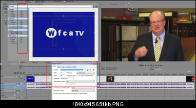

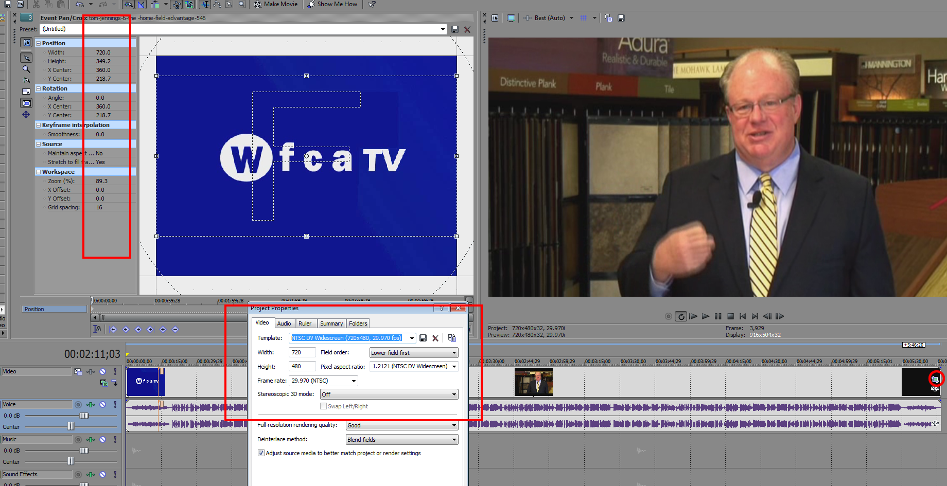

  23. Glad that worked for you. Here's another way.
