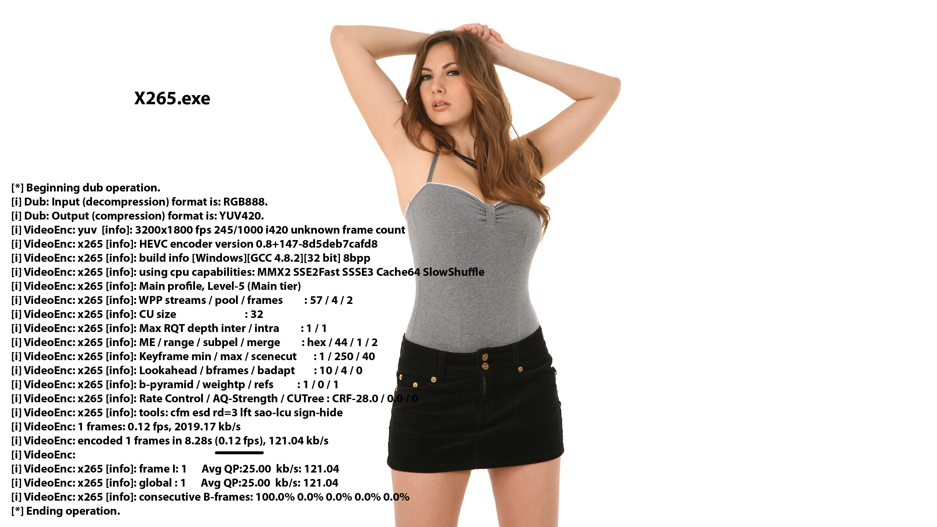

    Here is a one frame mkv that x265.exe created...
  3. a. updating x265 might help
    b. since x265 is a command line encoder post the command lines you used to create the clip; if you used some gui, to create the clip it might also be a problem of the gui
    -> without a sample of the original and command lines this is hard diagnose

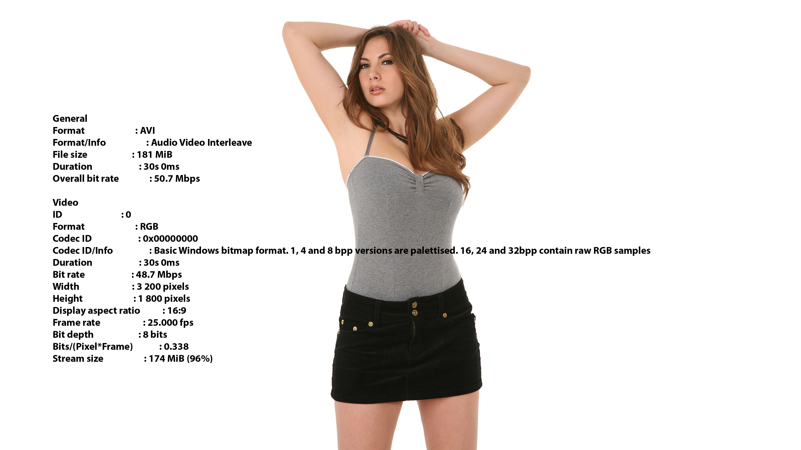

    I'm just using the ultrafast preset in Virtualdub. Here is a png from the original AVI...

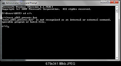

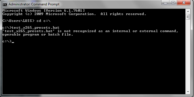

    Feb 2013
    check attached jpeg
    Aug 2013
    Central Germany
    Well, gonca, I fear this is not the right place to give you a lengthy introduction to using the command line interpreter. And changing the directory to C:\ is already suspicious, I would never recommend to store the batch files, the video files, and the encoder right there; instead, they should be at least in an own subdirectory, if not even another harddisk (to separate system and data).
