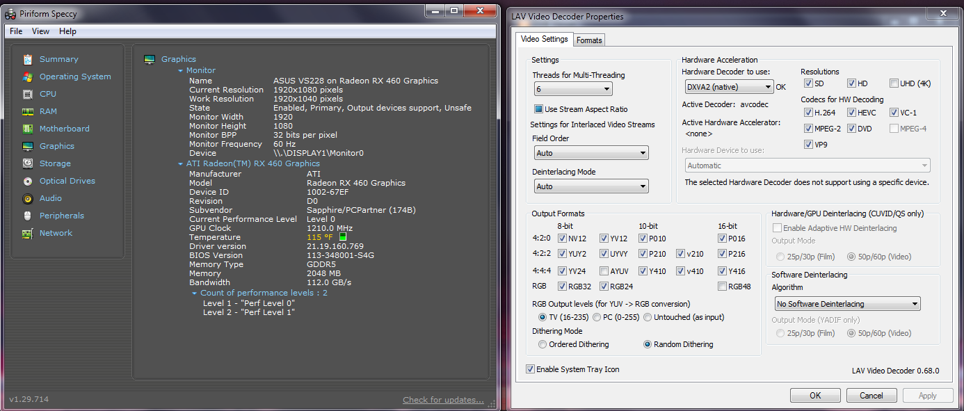

    My ATI 4670 (1GB) from 2008 did a pretty decent job of helping with decoding 720p/1080p HEVC content. Using MPC-HC with LAV Filters using DXVA2. I only recently changed it out with a AMD RX 460, and I'm still using DVXA2 without problem. But now I can also decode 4K HEVC in real time with the RX 460, which I could not do smoothly with the ATI 4670.
  6. Originally Posted by KarMa View Post
    No, it didn't. Not possible. You can set LAV Video to "DXVA2" and tick the "HEVC" box on any PC but LAV Video will simply fall back to software decoding with such an outdated card.
    I was getting pretty decent GPU (ATI 4670) usage spikes when using it for HD HEVC, like +40% in the ATI control panel. Taking a big load off of the CPU. Trying to play the video in VLC would either cause the CPU to take all the load, and usually causing 100% peaks which gave dropped frames. Never had dropped frames in MPC-HC until I started trying 4K content, for both H.264 or HEVC.
  8. You can see directly in LAV Video what decoder is active. No need to look at unreliable info about GPU usage which may be used for other things like scaling by the renderer. VLC's decoder was known to be slow, LAV author cherry-picked optimizations from OpenHEVC. LAV 64 was (still is?) like 3 or 4 times faster for HEVC decoding than VLC 32.
  9. Dinosaur Supervisor KarMa's Avatar
    Jul 2015
    US
    It mostly hung out around 10-0% when doing nothing. So that's some pretty weird scaling demand when watching 1080p content on a 1080p screen. I'd also watch the temperature gauge which also acted like I was playing a video game, going to the 130-150F range.
  10. I see we already had this discussion before:
    https://forum.videohelp.com/threads/379693-Struggles-when-playing-back-certain-4K-files...=1#post2453848
    You can even see in your screenshot that it was using "avcodec"(=ffmpeg software decoder) with "<none>" as "Active Hardware Accelerator", not DXVA.
    It was not much of a discussion but just me posting a comment and you replying.
    I have no idea what I was decoding in that screen shot, or that I went out of my way to decode a HEVC video in that shot. I might of also just opened any SD I had, as you can see the SD box is unticked. I can even get the same thing today when using DVB Viewer to decode H.264 1080i video over the air, or playing SD content through MPC-HC. https://forum.videohelp.com/images/imgfiles/neLLDtp.png
    I'm pretty certain that the "Active Hardware Accelerator" would say "4600 Series", and the "Active Decoder" would say DXVA2. When decoding HD H.264 or HEVC in MPC-HC. I could reinstall the 4670 as I still have it. But am not eager to do that as installing the RX 460 and getting it working properly took an entire evening.
    What are you going off that makes you believe the 4670 could never use DXVA2 (native). I've see it stated that the "AMD/ATI: Radeon HD 6xxx and newer" are needed for for DXVA2 (copy back) but native is supported on older cards.
    Also found this. http://kodi.wiki/view/HOW-TO:Enable_Hardware_Accelerated_Decoding_via_DXVA2_in_XBMC_for_Windows

  13. Originally Posted by KarMa View Post
    Then it is using software decoding. For example because the renderer doesn't support DXVA2 native or because there's an intermediate filter breaking the chain.
    I didn't say it doesn't support DXVA2. I'm saying it doesn't support HEVC decoding via DXVA2. Just like your RX 460 driver supports HEVC DXVA2 but not VP9 (though AMD has promised future driver for VP9 on Polaris). Every format needs to be implemented separately by the GPU driver. And this simply isn't the case for older GPUs and HEVC.

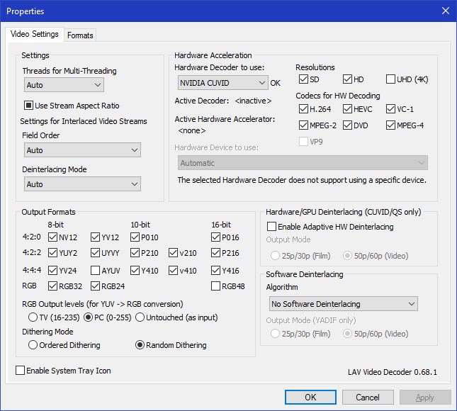

    Using CUVID hardware decoding on a GeForce 9800 GT. This setting only became available after installing the OpenCL Strongene HEVC decoder. Also works on an 8800 GT but not quite as well due to the less powerful GPU.

  15. Like I said, watch the "Active Decoder:" item. It will be "avcodec" when playing HEVC on a PC with only an old GPU. No matter if CUVID, DXVA2 or QuickSync. You're fooling yourselves.
    Apr 2007
    What matters is how well or not it plays. With the dual core socket 939 - without Strongene OpenCL and LAV *with the CUVID selected* it could not play 720P HEVC video without a ton of stuttering.
