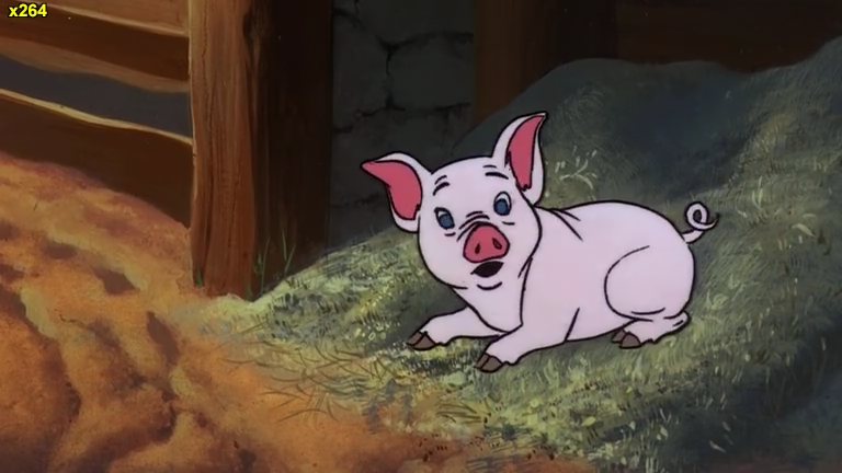

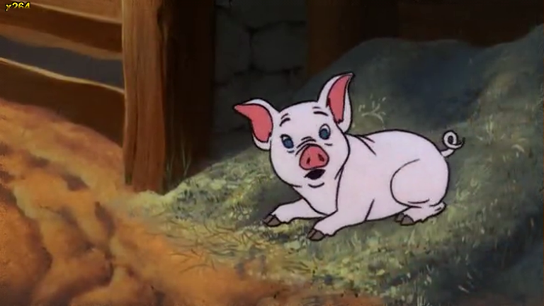

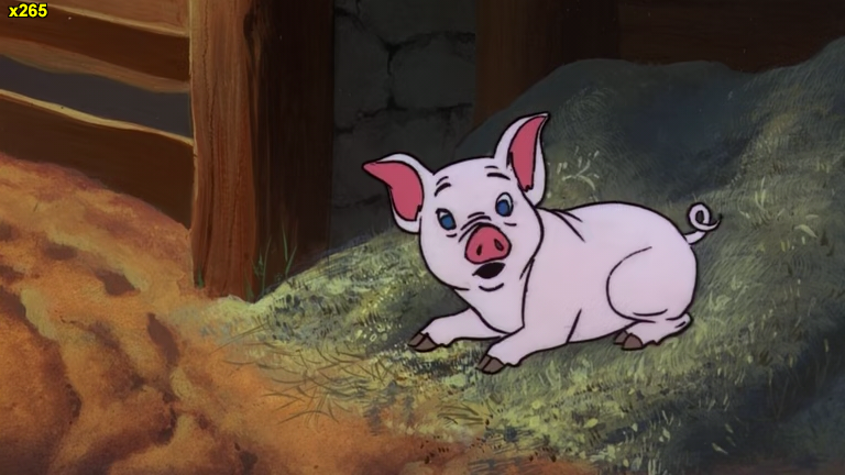

  11. I encoded another animated feature length movie which was an early codec experiment of mine back in 2008. Back then I emphasized compression over quality so I encoded it to 200MB (including audio) and the quality sucked but it was watchable. Part of the reason I was so careless is cuz I intended to archive this film (I haven't watched it since that day 7 years ago).
    I remember reading and drooling about H.265 that month on h265.net, wondering how awesome it would be.
    Now that x265 is out I wanted to see what it would look like today at the same size. But first I encoded all over again with the latest x264 and with proper parameters this time. I can't believe my eyes, look how awesome the quality is. All three of them are the same bitrate, about 0.050 BPP.
    However, x264 has been massively improved since 2008 so x265 regrettably has only about 25% better efficiency than its fully-mature predecessor.

    Aug 2013
    Central Germany
    Originally Posted by -Habanero- View Post
    And I have no idea why the first image was brightened when I uploaded it but that's not how it should look at all. What's wrong with this site?
    Nothing. But your earlier encode or decode/screenshot may not have respected the TV/PC scale conversion (TV luma range = 16-235; PC luma range = 0-255).
  13. Hmm, weird. The only difference is the 2008 encode was 8-bit and the new ones are 10-bit. I fixed it now by converting with mspaint.
    You can't really notice much of a visual difference between mature x264 and immature x265 unless you directly compare.

    Well shit, x265 has produced worse quality than x264 for this test file. For others, they do a little better than x264 but worse than x265 1.4. If this is only happening to me I'd like to know exactly what I'm doing wrong.
    Commandline used:
    avs4x26x.exe --x26x-binary x265 ng2.avs --crf 41.1 --preset veryslow --ref 16 --bframes 16 --keyint 600 --no-psy-rd --no-psy-rdoq --rc-lookahead 250 --qcomp 0.7 --allow-non-conformance -o "ng2.hevc"

    for general amusement I attached my first try to encode such stuff with x265 (without avisynth),... for me it looks way better than your encodes
