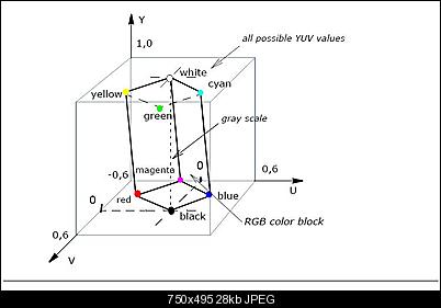

    YV12 is a FourCC which describes planar YUV 4:2:0 video. If Y, U and V had all the full resolution, you would have 3×8 bit = 24 bit per pixel; but because in 4:2:0 chroma subsampling, (simplified) a square of 2×2 pixels shares the same U and V chroma difference values, you will only have 4+1+1 = 6 Bytes = 48 bits for each 4 pixels, this makes an average of 48:4 = 12 bits per pixel.
    Banding may occur mostly due to quantization of the transformed parameters in a frequency domain, but partially also due to some rounding errors during a conversion from YUV back to RGB, for displaying on a monitor using RGB additive color mixture. Giving the YUV samples a higher precision than 8 bit per component doesn't make much sense when the internal precision of the frequency parameters is still limited to 8 bit before quantization which reduces the precision even more.
    x265 comes in flavours with either 8 bit precision of internal parameters, or with "up to 16 bit" precision ("High Bit Depth", currently implemented for 10 bit precision to create Main10 or High10 profile HEVC bitstreams); "bpp" is rather meant as "bits per parameter", not "bits per pixel (component)", as it is related to parameters after a transformation to a frequency domain (you may have learned about the Fourier transform in school, the transforms used in video compression are similar but limited in range, therefore limited in the number of parameters, whereas Fourier transforms are for infinite periodical functions with infinite sums of parameters).
    The optimum to avoid banding would be that both AviSynth filters video with more than 8 bit precision per YUV component (DeepColor mode; currently very limited support), and x265 transforms it to frequency parameters with more than 8 bit precision (High Bit Depth build).
    "RGB is called 10-bit" is a completely wrong statement.
    Makes sense. Small question, does converting from RGB24 to YV24 impact the quality at all? It doesn't seem to.

    Yes it does. This is a lossy conversion. RGB and YUV are non overlapping color models. You always incur loss - whether or not it's "visible" is a different matter

    "Colorspace" and "bit depth" are independent - eg. You can have 8bit RGB, you can have 10bit RGB, you can have 8bit YUV, you can have 10bit YUV . RGB encoding is less efficient
