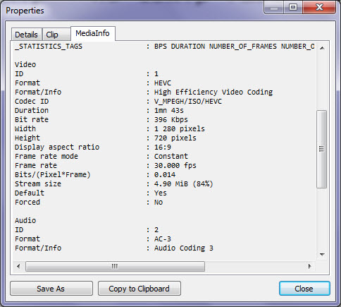

    Originally Posted by nima2010 View Post
    ... but when i check media file with mpc there isnt any info about that is 10bit or 8 bit also nothing else for rest setting too
    plz tell how i can find out about encode setting from encoded file with x265
    There is a "MediaInfo" tab in the details dialog (Shift+F10). The "Format profile" should tell you about whether 8 bit depth or a higher bit dept was used, if you know how to interpret its value. In addition, there is even a "Bit depth" field a bit lower in the text table.

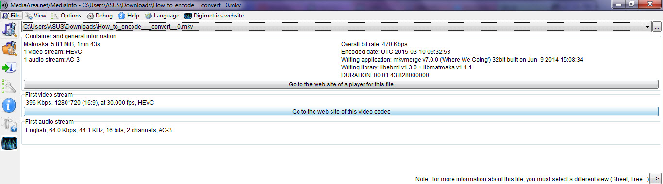

  7. thanks for responding
    about media info i download media info tools too but still cant see encode setting form media info ,i upload mpc media info here
    thats all i can know about hevc video
    [Attachment 30668 - Click to enlarge]
    Aug 2013
    Central Germany
    Which MPC-HC version do you have? Version 1.7.8 should contain a MediaInfo version which is able to report such details. But possibly only if the HEVC video stream was created by x265; I am not sure if all other HEVC encoders out there will produce the same "completeness" of the headers.
    You can also try to use MediaInfo as separate application. If you can use the CLI version, use the parameter "-f"; if you prefer the GUI version (be careful to avoid adware while installing), enable the "Advanced mode" in the Debug menu, then export the result as text, so you can post it as a CODE block here (or a link to a pastebin service).

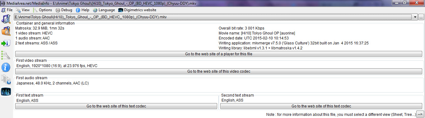

  9. my mpc ver is 1.7.8.61 i have k lite codec 11
    i test it with 2 different file but still no info ,this time i use media info tools
    [Attachment 30669 - Click to enlarge]
    [Attachment 30670 - Click to enlarge]
    how can i get CLI or GUI ver? also what is the best encoder for x265 right now?

    Aug 2013
    Central Germany
    ZOMFG, he has a Codec Pack !!!1eleven! ... despite the fact that MPC-HC won't need any, because it uses LAV Filters. Codec packs can only corrupt your system if you don't know how to handle them carefully.
    And he asks What is the best!!!1eleven! without knowing that x265 itself is the encoder, and everything else is only a user interface. Summary: It doesn't matter much, whether you use MeGUI or StaxRip or Hybrid or HandBrake or any other x265 GUI; they all only take your mouse clicks and key presses, but x265 does the real job.
    By the way: VideoHelp downloads of MediaInfo will offer you the GUI version (you will find the letters "GUI" in the filename of the archives you download there). The one with a window, where you can click with a mouse arrow. (CLI would be the one where you have to type commands in a console, grey on black, you know...)
    And I asked you to use the "Text" format output, and enable the "Advanced mode" in the "Debug" menu ...

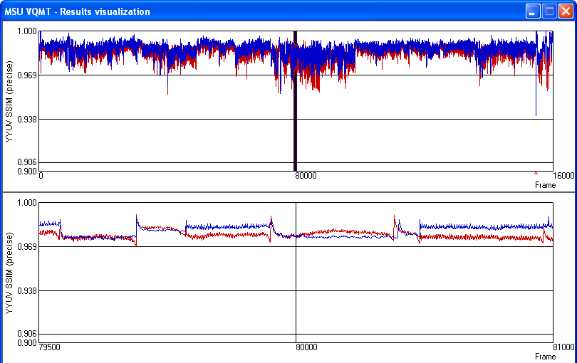

    I have evaluated the quality of the movie and compared it to an x264 encode of the same bitrate. x265 is 16% better according to SSIM which is just at the border of being able to notice a difference and most frames have a consistently elevated score on the histogram. But SSIM is starting to show its age. On the many frames where x264 and x265 both got a similar score, x265 still looked noticeably better as well as on some scenes where x265 actually scored lower but still looked better for preserving more important details and distorting other areas in a way that didn't make them look unsightly unlike x264 which was rife with edge distortion.
    We need a more modern metric. Just like PSNR was obsoleted by SSIM, we need something new this decade.
    Progress is definitely here but the 20x slower encoding time is really not worth it. My movie is only 480p, not a chance in hell I'll ever encode 720p with this.
    On the other hand, the MPEG-1 prototype in 1988 took 12 hours to encode and 30 minutes to decode... A SINGLE FRAME. Yet years later videos were being encoded at comfortable speeds. I have faith in the holy Techno Goddess to save us this millennium as well.
Name:	Feature length x265 vs x264.PNG

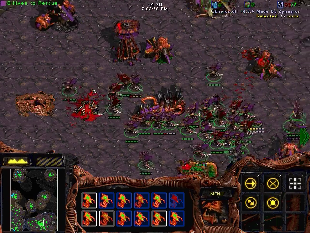

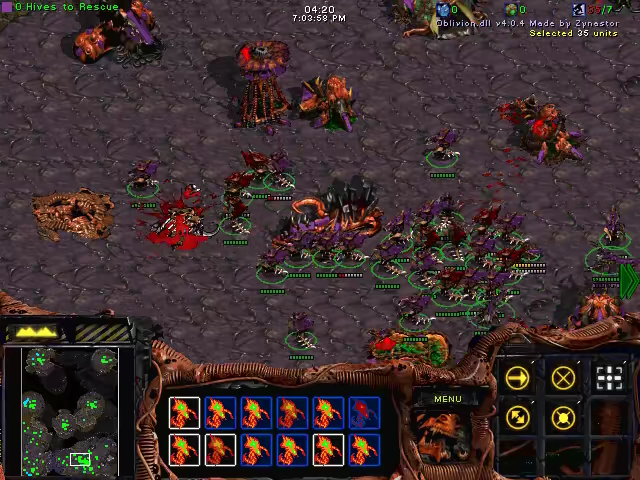

  19. I did a few tests on a short 4-minute game video which took almost 2 hours with x265.
    Commandline:
    avs2yuv "SCBW z1.avs" -o - | x265 --y4m --pass 2 --bitrate 511 --preset veryslow --stats "M:\x265.stats" --ref 16 --keyint 600 --no-psy-rd --no-psy-rdoq -o "SCBW z1.hevc" -
    For this one I'm gonna have to say x264 was better quality at the same bitrate. x265 retained slightly better quality on moving objects but unacceptably blurred the static background. I tried with and without psychovisuals and I can't tell the difference.
    Screenshots:
    Edit: I should've subtitled them. The order is Source, x264, x265, x265psy
