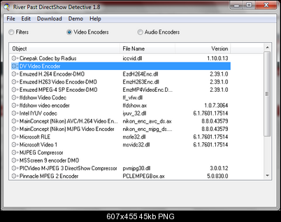

    OK downloaded the River Past DirectShow detective and found out that I have the same problem, but the regsvr32 qdv.dll fix gives me a message that the .dll has been registered successfully, but after I restart the DirectShow detective the situation is the same, of course I tried rebooting the PC.
    I also tried Scenanalayzer Live, that can use the camera's controls but tells me that there is no video coming through so now I'm sure that the problem is with the DV encoder/Decoder, but how do I get it registered in Win 7 64bit?
