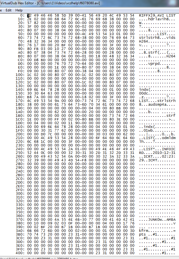

    Sure. Here are 2 files. The #8080 shows a thumbnail in explorer and maybe plays for 1 second. The second file, #2224, is of similar size but should be about a minute in length.

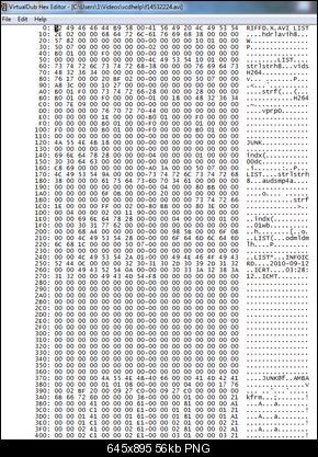

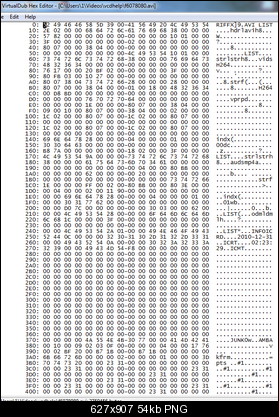

    looks like junk parts of old files the recovery software collected and made into files. not much in them and they are not video for the most part. especially the second one it's mostly 0's.

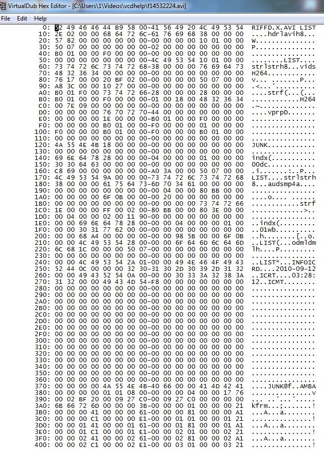

    I've uploaded 2 more of the largest files if you're interested in looking at a couple more.

    why are there .m2ts and avi files on the same card? was it used in 2 different videocams? the avi files don't make much sense. they don't have normal size video listed for them and they were recorded in mp4 but called avi?
    i looked at the largest one. again it's just a header attached to junk. open it in the hexeditor included with virtualdub. after the file says "junk" on line 12 it's 99% blank - all 0's.

    The 73MB file above is 95% binary zeroes, the rest looks like indexing data. The 21MB file also is mostly binary zero,
    but there does seem to be some data in there which may be valid.
