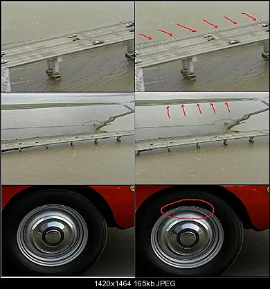

My problem is that every time I try to convert the video, the quality of the convertion is never as good as the original video. No matter what bitrate or target codec I choose.
Here is an example of what I'm talking about:
Original video on the left, converted video on the right.
As you can see, the problem seems to affect diagonal lines which are closer to be horizontal.
I attached an extract of both the original video and the converted one in case you want to see for yourself.
Do you know what tool can I use to solve this problem and the options/configurations I should tune up??
	It looks like you're deinterlacing when you shouldn't be. See if there is an option to turn off the deinterlacing

 I downloaded VidCoder (which uses HandBrake under the hood) and the converted video turned out just like the original.
