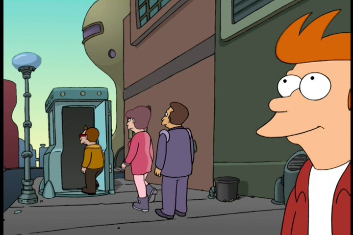

    Frame 49? What's your framerate, 19.98fps? This is what I get with both frames 61 and 62:
