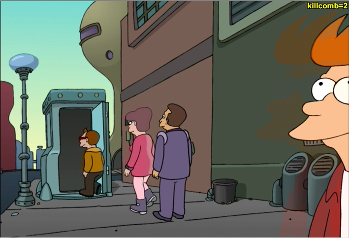

  1. I have some 3:2 pulldown material which is animated. I'm using AnimeIVTC with the following script, but I believe that there is "chroma ghosting" I can't figure out how to deal with it. This is the script I'm using and here's an example of the ghosting:
    AnimeIVTC(mode=1, killcomb=3)
    https://forum.videohelp.com/images/imgfiles/hOAhQJN.png
    I believe that this script here might help: http://forum.doom9.org/showthread.php?p=1582950#post1582950
    When I try and use it, I get an error in vdub saying that there's no function for "average" for srestore.avsi. Also, here's an example without "killcomb": https://forum.videohelp.com/images/imgfiles/ISrVtkc.png

  3. Oh, sorry, I didn't realize that average was a dll I needed. The script works now, but it actually seems to have made it worse. While browsing external avs filters I came across this: http://forum.doom9.org/showthread.php?t=77074|
    However it doesn't contribute any improvement, luckily once the combing is removed by "killcomb" it becomes significantly less noticeable at full speed. It doesn't seem like any chroma filters or scripts are helping. Is it not chroma ghosting/bleeding?

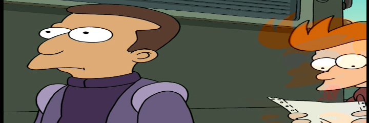

  9. I see, thanks, but when I use the script and open it in vdub, I still get weird frames like this one: https://forum.videohelp.com/images/imgfiles/Yp198Xv.png
  10. Are you seeking linearly ? You cannot seek all over the place with filters like srestore or many temporal filters . You have to go from several frames before (maybe a dozen or so) , frame by frame to the frame of interest . Non linear seeks often will give you mixed up frames with temporal filters

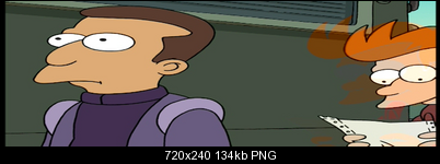

    SeparateFields()
    Take a look and you will see problems in individual fields . That is the underlying problem jagabo was describing. IT's due to improper interlaced handling of YV12<=>RGB conversion
    That' s in your original source

    This is what I get on frame 49.
  29. yeah, I can't reproduce that result. Very weird.
