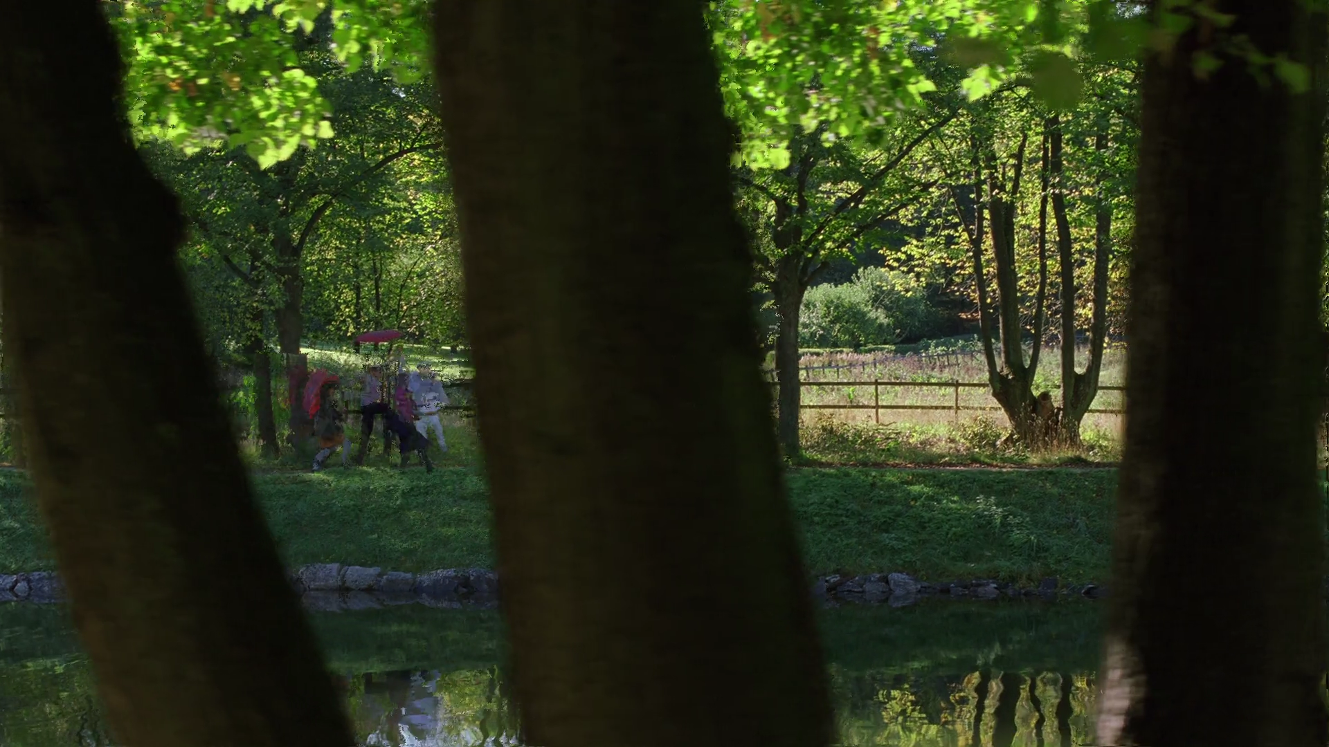

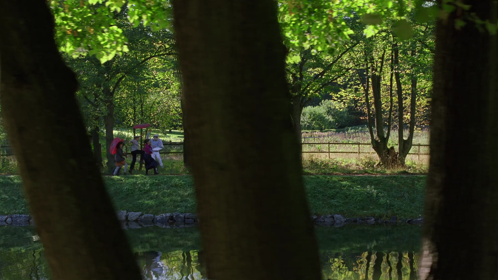

    Here is one of their examples look at the frame before and after. The software gets "confused" by the trees because the software cannot determine accurately the edges of the trees vs. the people

Name:	8 parkjoy_isovideo.png

    Thank you poisondeathray for pointing out the blemish, but we have made significant improvements since the year-old example from isovideo.com site.

  17. @isovideo - That's good. Maybe it would be a good idea to update your "examples"
    Other optical flow methods do not "fail" as poorly on that old frame for parkrun either (e.g. mvtools2, twixtor, kronos)
    But all algorithms will have some "blemishes" or motion vector prediction fails in other areas . There will be no perfect automated solution
