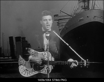

    A friend of mine rips his DVD's on a PC. I rip mine on a Mac. He then converts his VOB's to MPEG2's. I do the same on my Mac.
    Do we get the same MPEG2's? Much to our suprise we don't!
    My MPEG2's are given the extension .mpeg. His VOB's are given the extension .mpg. We thought this didn't matter, and we still do. But while he and I are able to play his MPEG's from a USB stick on tv, my MPEG's can't be played this way.
    Is there anyone who has an explanation for this?
    The software I use is MPEG Streamclip 1.9.2 (for the Mac this is the most popular MPEG editing software).
    The software my friend uses is MPEG Video Wizard DVD 5.0.
    The only other difference is: before converting his VOB's to MPEG2's, he amplifies the VOB's and converts to AC3 at 256kbps. I don't. I just convert from VOB to MPEG2.
    By the way, I can play my MPEG2's on my Mac using VLC or MPlayer OSX Extended. PC users are also able to play my MPEG2's on their computers.
    This is one of my MPEG2's:
    http://http://files.videohelp.com/u/203833/Mac%20(MPEG%20Streamclip).mpeg
    This is one of my friend's MPEG2's:
    http://files.videohelp.com/u/203833/PC%20(MPEG%20Video%20Wizard).mpeg
    As you can see it's the same video from the same source (DVD). The file structure seems to be the same. But it isn't!
