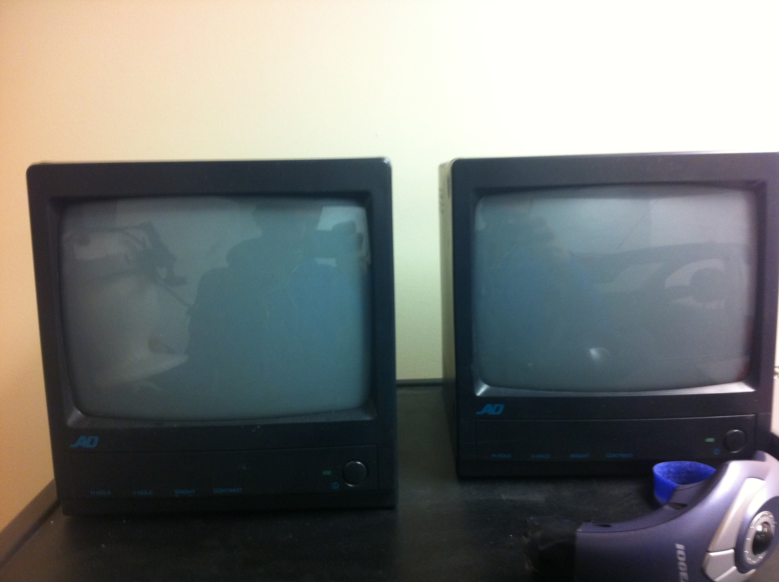

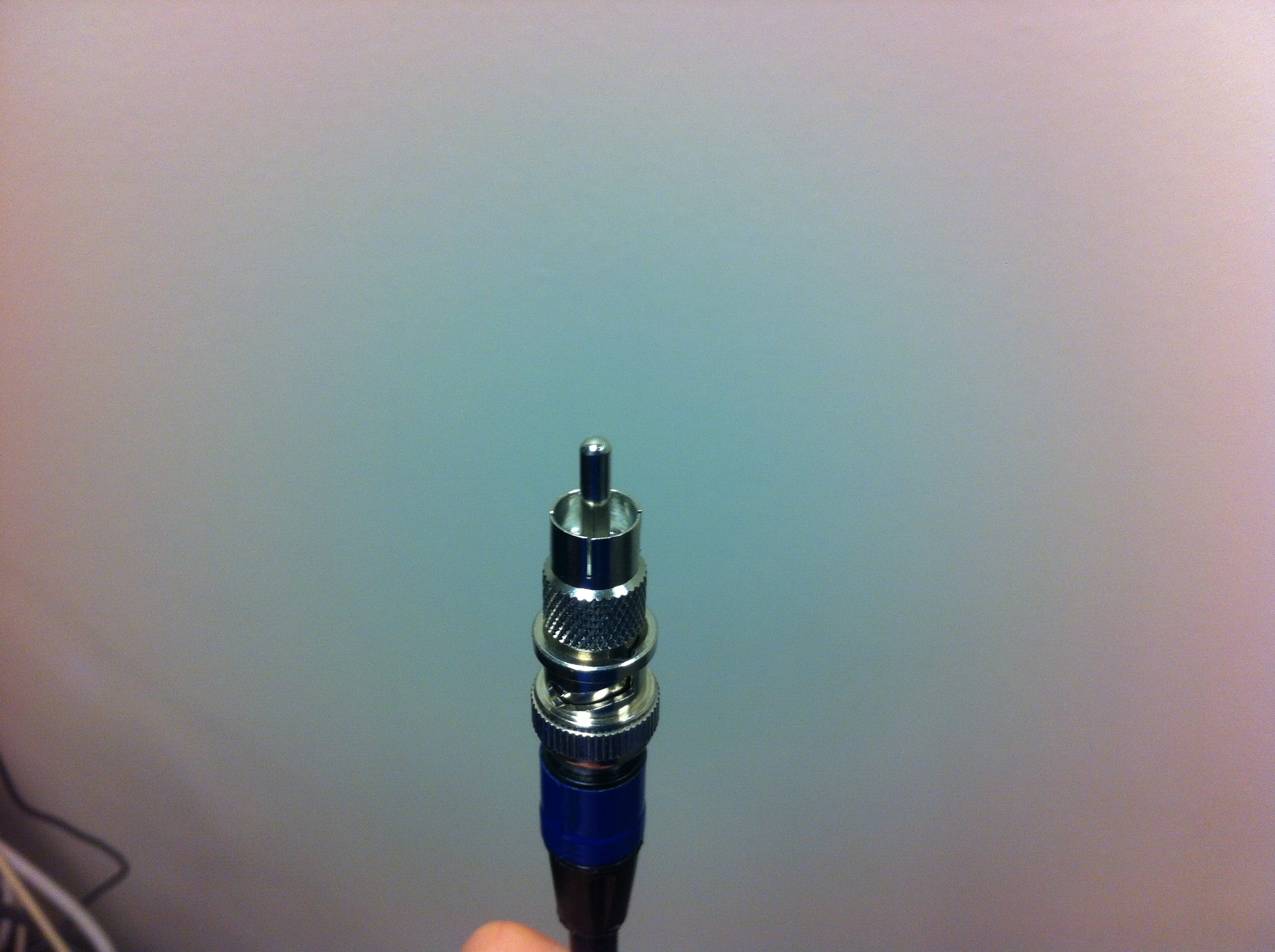

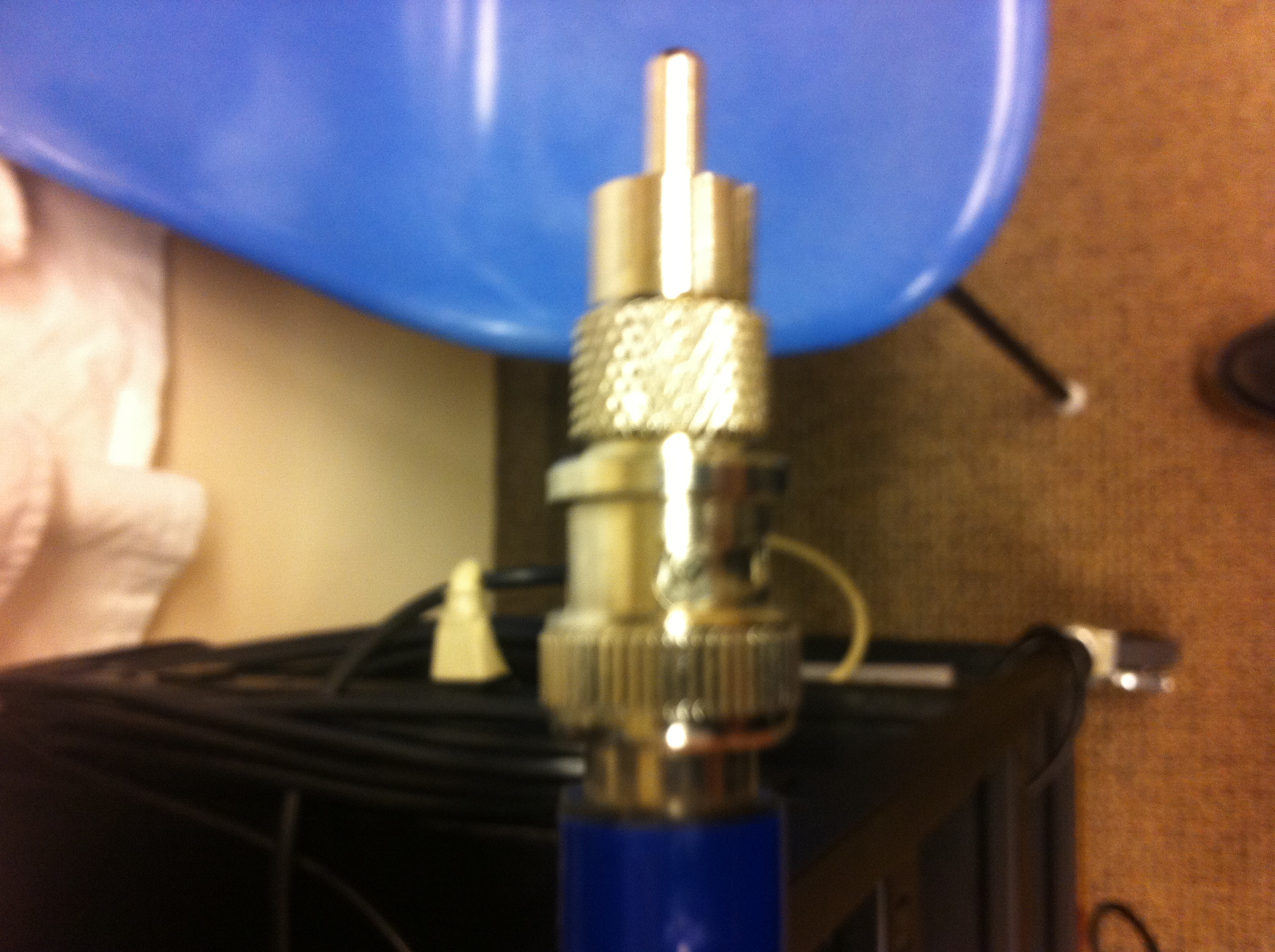

    In the IMG_0495 you can see the two monitors I have.Each of them shows the outputs from, respectively, the two cameras located on the eye tracker.
    In the IMG_0494, you can see the output (a BNC with a RCA adapted jack) of the monitor displaying what the participant actually sees. I need to capture and record that output.
    I hope I have been enough clear for you to understand.
    According to what usually_quiet said, I cannot use the VGA port on my laptop as an input port. I need a USB capture device with a composite connection.
    So..do you think that a thing like that may work?
    http://www.startech.com/AV/Converters/Video/USB-S-Video-and-Composite-Video-Capture-De...udio~SVID2USB2
    Thanks for your precious support!

    Aug 2006
    The Startech SVID2USB2 is a decent capture device. As I recall, the included GrabBee software comes with it is not especially good, but the hardware is known to work with many third-party capture programs. If you get it there is information in this review that could prove useful to obtain newer drivers http://www.amazon.com/review/R13EG4HUZZRZBW/ref=cm_cr_dp_title?ie=UTF8&ASIN=B000O5RIWO...re=electronics
    The Hauppauge USB-Live2 is another good option that is widely available: http://www.hauppauge.com/site/products/data_usblive2.html The manufacturer's provided WinTV v7 capture software is OK, but if you don't like it, there is third party capture software that will work with it too.
  11. First, route that BNC/RCA cable to a TV with composite input. Verify you get a picture. If you do, then any standard definition composite capture device should work.

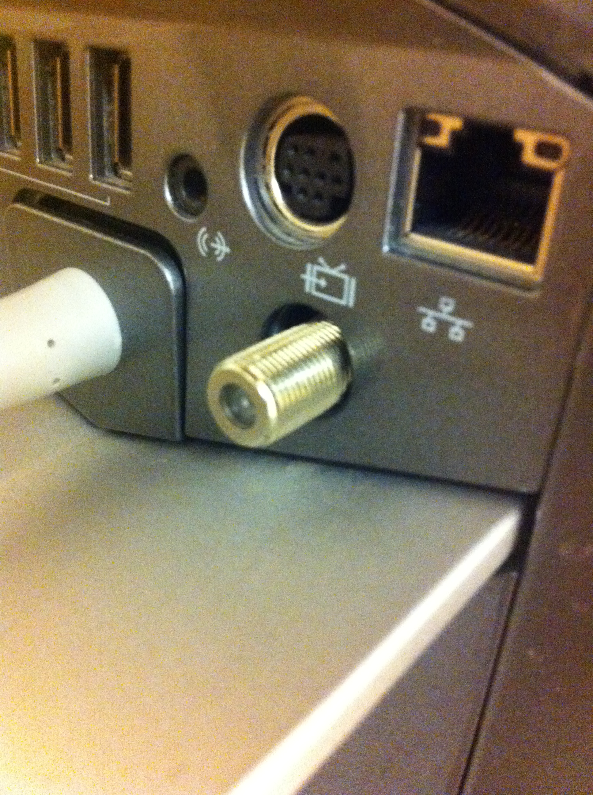

    Hi guys.
    I have another question.. I hope you can help.
    I have a computer with an antenna input (IMG_0522) and the same video RCA video output (IMG_0523).
    I need to plug the RCA into the computer through the antenna by using an adapter or something like that.
    I called Radio Shack and they told me to get an RCA modulator.
    Before buying it, I would like to get some advice from experts.
    Thanks a lot for your precious help!

  15. Yes, you need an RF modulator to convert composite video to a TV/cable channel. They usually use channel 2, 3 or 4. For example:
    http://www.amazon.com/Audiovox-Corporation-CRF907R-Compact-Modulator/dp/B0014KKV7W/
    Picture quality is generally worse than a straight composite connection.
    Nov 2013
    salt lake city
    Thanks!
    I ve seen that the RF modulator has an antenna female output.
    The computer has an antenna female output too.
    I just need an antenna male-to-male adapter then.
    Right?
    Thanks for your precious help

    All you need is a short length of RG6 coax cable to connect the RF modulator's outgoing connection to the antenna input on the PC. You can get one with the connectors you need for a few dollars at any store with an electronics department.
