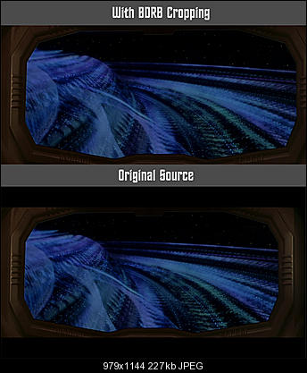

    I recently got into ripping Blu-Rays to the HDD and making some condensed files. I haven't worked much with MKV but I'm trying BDRebuilder. It's fine for a few movies I've tried so far, I like that it keeps the chapter index, and the ability to keep subtitles in, handy for those movies with bits of Alien language in them. One of them is Star Trek: TMP, but when I try to make an MKV file with the black bars cropped off, BDRB crops off a good portion of the right side as well. Has anyone else come across this problem? Does anyone have a fix besides just having the black bars included (which does work)?

    What do you use to frame serve, directshow or dgdecnv

    With DGDecNV you can manually adjust the cropping if need be. Don't know if it can be done with FFDShow, look in your workfiles folder. Size variations happen when using CRF for encoding. As fritzi93 said, sometimes autocrop gets fooled.

    @gonca, I'll look into DGDecNV, or just be lazy and keep the bars. I just did Star Trek II: TWoK, same thing happened, cropped on the right. Did John Carter before that, no problems. On a side note, can't they find a better print for ST:TWOK, grainy and soft as all get out. ST:TMP looked so much better.

  9. Banned
    Feb 2013
    With DGDecNV
    Deselect autocrop
    When BD_RB finishes extracting and starts encoding abort it
    Open the DGI file in WORKING
    Enter the cropping values
    Restart

    Well here's an update. I wasn't able to get DGDecNV or the equivalent for me to work with BDRB. Thanks for the advice, but I guess I'll just convert them with the black bars. I did notice that cropping the black bars also threw off the positioning of subtitles to the point where they were right at the bottom of the frame. So I guess I'll leave well enough alone for wider letterboxed films. Now I'm trying to crop out the pillar boxes on some Star Trek episodes and that's not going so well with the first try. BDBR gives an option to crop to 1440x1080 in Settings, but for Alternative Movie mode it's all 1920x1080. I tried it with AutoCropping Off and just made it the same with pillarbox, now converting with AutoCropping On. Should be this much work. ;P
