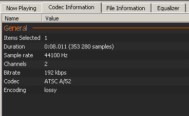

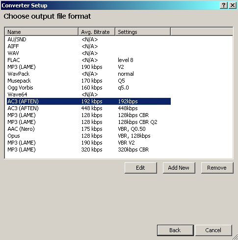

  2. Originally Posted by DonAns View Post
    You'll never be able to. AC3 is lossy. Therefore it doesn't have a fixed bitdepth. It can never be 24 or 16 bit etc.
    I always use MediaInfo to check the data. It says 16 bit. So that this is a wrong information?
    I'm not 100% sure. Maybe the Dolby spec is for it to be decoded to 16bit so that's what MediaInfo reports, but I tried converting a 24bit wave file to AC3 and MediaInfo still reports it as being 16bit. It seems to always report lossy DTS as 24bit so maybe that's inline with the specification for decoding it too.

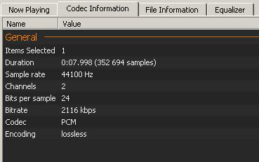

    If in doubt, I go by what foobar2000 tells me as it doesn't seem to lie. Here's what the codec information looks like for a 24 bit wave file.
    Same again for AC3 (or any other lossy codec). Note there's no longer any "bits per sample" information.

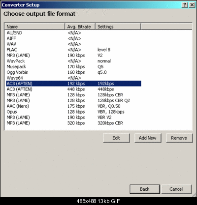

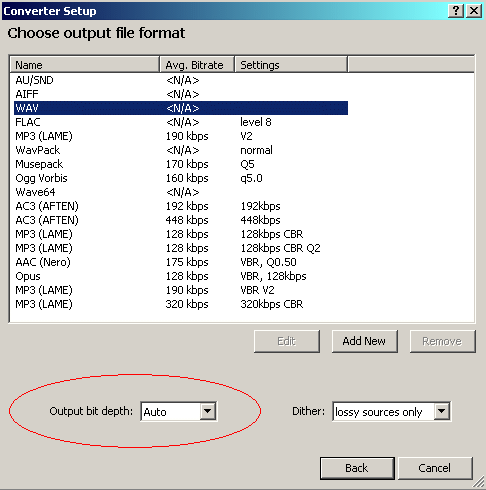

    And when configuring the encoders, there's no option to set a bitdepth for any of the lossy formats as there is for the lossless ones.
ID:	21035Click image for larger version

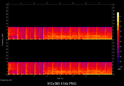

  5. Originally Posted by vaporeon800 View Post
    A quick and simple "casual listening" test for anyone who wants to try it.
    I'm no audiophile, but the difference between 32k and 24k was immediately obvious on my headphones.
    Are you sure that you can distinguish between two exactly same audio where difference is only sample rate and your equipment perform correct reproduction?

  12. Originally Posted by hello_hello View Post
    You didn't ask about the methodology behind providing samples, you asked about comparing vegetables with fruits and about comparing the incomparable, but unfortunately I'd not managed to get my crystal ball working to decipher what you were talking about. Now you've provided samples yourself without explaining the mythology behind those or without attempting to explain why they're more comparable, so I still have no idea what point you're trying to make. Is English your second language because obviously there's a communication problem.
    My point was that generating those samples was unnecessary as every higher sample rate version have more energy up to resampler stopband thus this comparison is not a comparison or judging - to judge how you can hear difference between sample rates you need to have same signal source that is band limited then you can compare different sample rates - in case of your samples each time you comparing different signal (i know this is the same recording but still - signal is completely different). And yes, English is not my native, also it is self learned thus i apologize for any mistakes and communication errors.
    After trying the crystal ball again I'm thinking maybe you took a low sample rate version and resampled it at a higher sample rates in order to compare them but I've no idea what the point of doing so might be. Did you understand why I uploaded those samples in the first place? They were just "quick and simple" examples offered as part of a discussion regarding how low a sample rate you could get away with for "casual listening", and not something from which scientific conclusions were expected to be made.
    More or less, your source file was filtered in sinc filter (lowpass, 7.75k) then -3.01dB gain was applied, next samplerate conversion to 16000Hz was performed, later this signal was used to create remain samplerates and now they can be compared as they have almost identical energy and they are correlated and comparison can be made.
    Casual listening is confusing description - with few techniques (like spectral band replication/extrapolation) probably 16000Hz sample rate will be enough or even less than 16000Hz and so what? - for casual listening comparision one you intended to perform, low pass filter should be used not different sample rates as key is low pass filtering not sample rate.
    If you really need to know the methology used, I simply took the beginning of a CD track and re-converted it to wave files with foobar2000 while changing the sample rate each time with the Resampler DSP. I have no idea how clever a resampler it is compared to other methods. They were quick and simple sample rate comparisons as part of a discussion.
    Each time you just generated different signal - going on fruit methodology - apple, same type, at various stage of grow - from barely visible through various stages grow up to perfect, ripe fruit and where is point for this - unripe apple vs ripe apple - what is your choice? And this have nothing to do with sample rate but with bandwidth of the signal itself - decent resampler just perform antialiasing lowpass filtration but you can resample signal without lowpass and you can introduce aliasing and i know people that find such audio better than correctly antialias filtered.

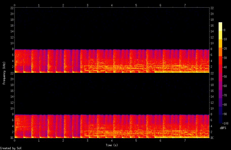

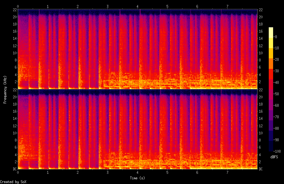

    This is the point im trying to make...

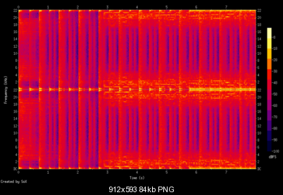

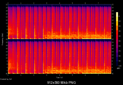

ID:	21049Click image for larger version

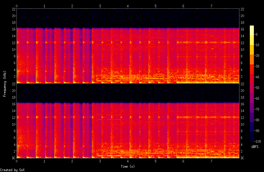

    Additionally - i've performed downsampling by 2 i.e. down to 22050Hz and upsampling back to 44100 but without antialiasing filtering - what is your opinion? About samplerate conversion without anitaliasing? (btw file is less loud, -3.01dB - reason is that in original file clipping occure - visible also on spectrogram)
  13. I think we're just looking at the topic from opposite angles. The original discussion was in regard to the minimum sampling rate required for "casual listening". In the context of the discussion, to me we were effectively discussing the minimum frequency response required for casual listening, but of course that would in turn dictate the sampling rate required.... which is why "sampling rate" was being referred to.
    The idea of posting samples wasn't to compare sampling rates as such, but to (roughly) determine if a 32k sampling rate could reproduce a frequency response adequate for "casual listening" and whether the difference between 32k and 44.1k would be noticeable.
    Yes, I guess I could have used just a low pass filter and left the sampling rate out of the equation, but that's why I called it a quick and simple test.... it was never intended to be anything very "scientific". Plus then there'd no doubt be people questioning the low pass filtering used if the sampling rate remained the same each time..... there's really no way to win (please everyone) when posting samples from a quick experiment like that (do a Google search on "ABX test" and you'll probably even find links where people claim the ABX test itself skews the results of an ABX listening test..... sigh....).

    Crude example of resampling without bandlimited signal - alias obviously audible but still some people prefer this kind of sound over "dull" correctly processed audio.
