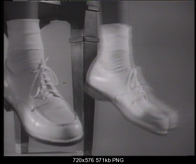

    It's the same with the other two new videos. They resized interlaced video (720x576 to 720x480) treating it as progressive video. The two fields are co-mingled. Complete trash. Nothing else matters as this is a catastrophic failure on their part.

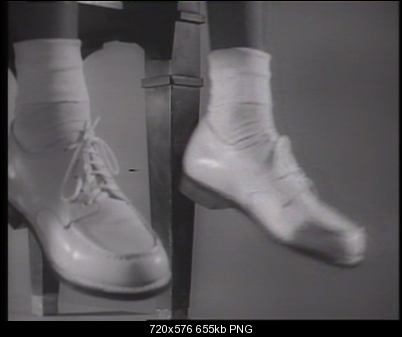

    For example, from the old Swing 1, this frame contains two half pictures:

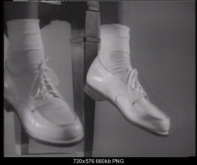

    The two half picture converted to two single pictures with a simple bob algorithm:

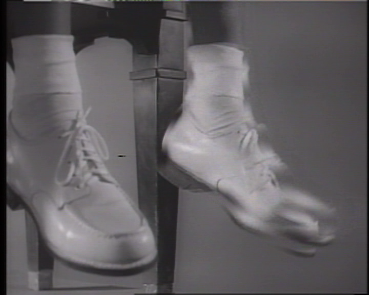

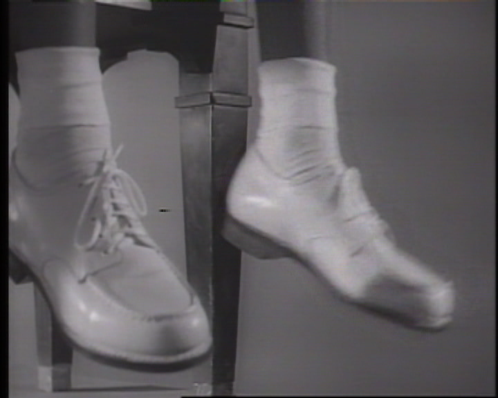

    Their new version cannot be split into two "clean" images:
    If your laserdiscs are NTSC they should go back to step one and capture as NTSC, 720x480, interlaced, 29.97 fps. If the discs are PAL they should capture them as PAL, 720x576, interlaced, 25 fps. They should give you the raw caps. They should not attempt to process the video in any way as they have no idea what they're doing.

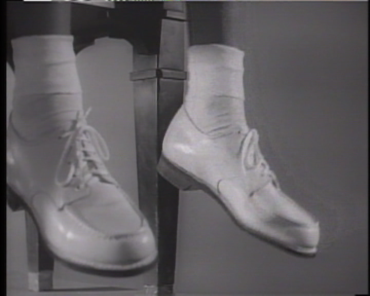

  23. I noticed the differences in levels, but when I saw the interlacing problem I didn't bother looking more closely. I don't know why the overall brightness of the picture went up. The additional noise is partly because the additional brightness makes the noise more obvious, but beyond that it may be a result of the resizing filter he used to go from 720x576 to 720x480. A "sharp" resizer will increase noise.
    Since I like the kid (do you know who he is?) here's the old Swing1 after little processing. A little too dark?

    Jagabo, The new Swing 1 excerpt looks excellent. Unbelievable you were able to make something out of this mess.
    The boy's name is Sugar Chile Robinson. He's the best.
  25. That was made from the old Swing1, not the new one.
    Thanks. His feet can't even reach the pedals!
