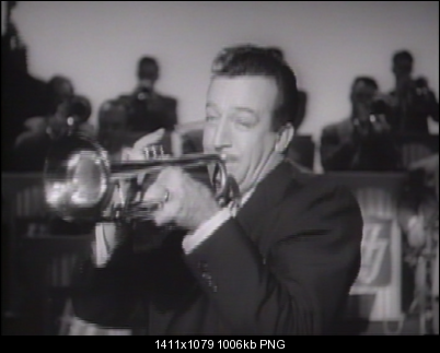

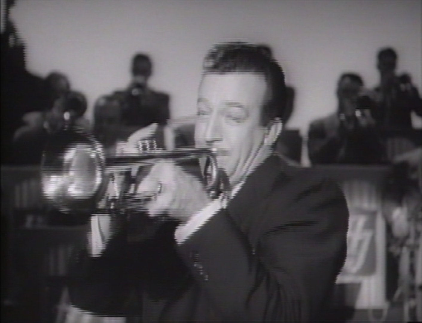

    A company specialised in video and film transfers, transfered two of my laserdiscs to DV.
    I'm not sure if I'm happy with the way this was done. There are some speckles due to laserdisc rot. I can live with that. But through most of the film ugly horizontal lines appear.
    Is this caused by laser rot? Are the lines originally printed on the laser disc? Or was it the company that did a lousy job?
    By the way, there are also color artefacts (in this black & white movie). Is this normal? Or should the movielab have filtered those out?
  2. Laserdics is an interlaced medium like all standard definition TV. So comb artifacts are normal. When played correctly (and assuming the video was prepared correctly) you won't see them. But since you resized the frame in your screenshot we can't tell if the problems in the picture are from your resizing or in the file. And yes, color "rainbow" artifacts are normal in caps of black and white material. Should they have filtered it out? Did you ask for it to be filtered out? Are there color sections (studio logos, etc.) that you would not want reduced to black and white?
    A short video sample (that has not been reencoded) that shows the issues would be more elucidating.
    See also www.100fps.com for interlacing issues.
    But as jagabo mentions we need short sample from the dv. Use for example makesample to cut a shorter clip.

    Holland, Europe
    Thank you for your quick response!
    I'm aware of laserdisc being an interlaced medium. But to me these "comb artefacts" don't look normal.
    I didn't ask the filmlab to filter the "rainbow" artefacts out, but I thought I didn't have to. And yes there are color sections at te beginning of the laser discs, but I don't care if they are reduced to black and white.
    Anyway, I'm uploading a sample now from the DV to both Videohelp and YouTube. This may take some time. YouTube indicates 33 minutes.

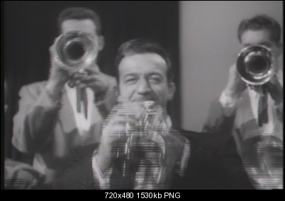

  13. Looks like improperly resized interlacing -- the bars are uneven widths. Also a frame rate change, looks like 6 good fields followed by 4 mixed ones. That may be simply 24->30 or it may have had a PAL life in there somewhere.
    Don't know enough about LD to know what the original would have been.
  14. I've only seen a few seconds at the beginning of the file (it's still downloading) but I agree, the interlacing is screwed up. The video was improperly resized and the two fields are co-mingled. There's no fixing this.

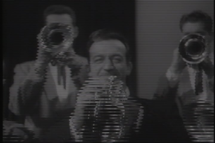

  20. This isn't normal interlacing. Looks like they scaled it for some odd reason. Here is one of the fields.
    Darryl
Name:	ld transfer.jpg

    however, i agree with everyone else, that source interlace is screwed up due to an additional conversion somewhere. probably was a 576/25i and they resized it down to 480/30i. i don't even know why this would be done since you live in a PAL region.

    I have to apologize to you guys. I misinformed you. Like Jagabo suspected, it was I who screwed up the sample.
    To make a sample I fed the original file to MPEG Streamclip. I then selected a film segment and pushed the "export to DV" button. Since the original file is a DVC wrapped in a .mov container, I thought I would get the same DVC, but without the .mov container. I know now I didn't get the same DVC. MPEG Streamclip converted the original PAL DVC to a NTSC DVC!
    I don't know why this happened. But could this have to do with a mistake the videolab made? I asked them to convert my NTSC laserdiscs to DV NTSC, since I thought it's probably best to maintain the native format (although I live in a Pal region). In stead of this the filmlab converted the NTSC laserdiscs to a PAL DVC.
    This is a sample of the original file:
    http://files.videohelp.com/u/203833/original%20laserdisc%20caputure%20file.mov
    I just checked. It's PAL DVC like the complete original file.
  24. Member Cornucopia's Avatar
    Another example of MPEGStreamclip screwing things up. Even if you "helped it along" by not knowing what you had and what it was going to end up being.
    But if you asked them (the studio) to maintain NTSC, they should have done that, or told you they couldn't do that!
  25. So now the question is why does the video have a PAL frame size but NTSC frame rate. Maybe the laserdisc was PAL and he kept the superior frame size, but decided you needed NTSC frame rate (23.976 fps progressive with hard 3:2 pulldown) to play it?
    Other than that, the black level is too high, there is some chroma noise, and lots of spots. A tracking problem causes the frame to jump around frame 160. But most of that can be fixed without causing much damage to the video. What is your final destination? DVD? MP4/MKV file?
    A quick cleanup attached. NTSC film frame rate and DVD frame size.

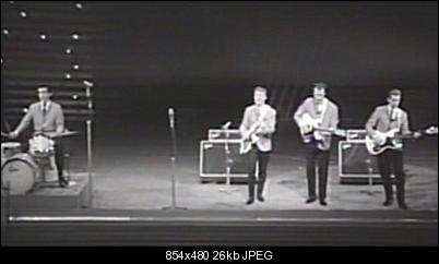

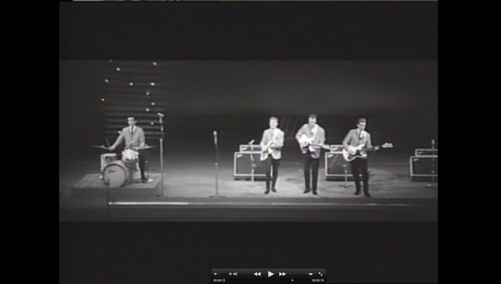

    I uploaded another sample from another laserdisc capture (done by the same filmlab). It's from a Japanese NTSC laserdisc. As you can see the aspect ratio is widescreen, but there are black bars all around. I therefore asked to get rid of the black bars on the top and bottom of the screen. But they are still there:
    http://files.videohelp.com/u/203833/Ventures%20sample.mov
Name:	Schermafbeelding 2013-11-02 om 11.40.34.png
  28. Originally Posted by HitTheRoad View Post
    That's amazing! The video looks way better. The speckles (laser disc rot?) have disappeared. The picture looks sharper.
    Yes, I adjusted levels and gamma, forced greyscale, sharpened a bit, used a spot remover (it missed a few), replaced a few jumpy frames, inverse telecined back to film frames, and resized the frame to NTSC standard 720x480.

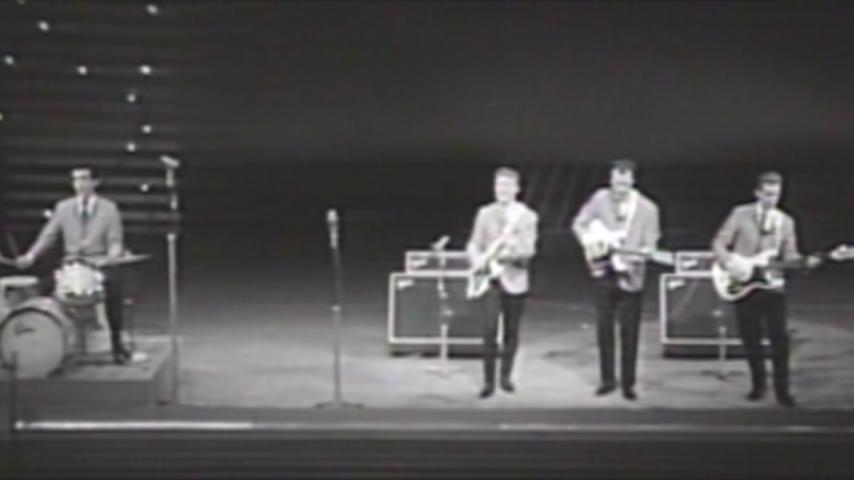

    That's a 2.35:1 source encoded in a 4:3 display aspect ratio frame. The black bars above and below the picture are on the laserdisc. But the darker black bars at the left and right are added by your player to fill your 16:9 screen. It's not realistic for you to expect them to deliver DV with no borders top and bottom. DV only supports two display aspect ratios: 4:3 and 16:9. Since the film source was wider than both of those the top and bottom must have black borders to fill out the frame. Unless you zoom and crop the frame (in which case you'll lose the left and right edged of the picture. Zoomed and cropped to 16:9:
    But this should be done after IVTC to progressive film frames, not while it's interlaced.

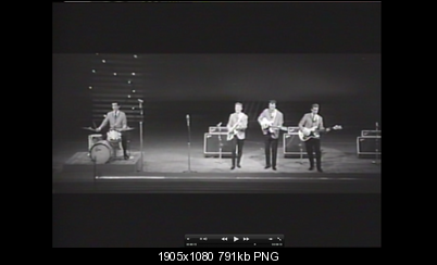

  29. Member
    Aug 2011
    Holland, Europe

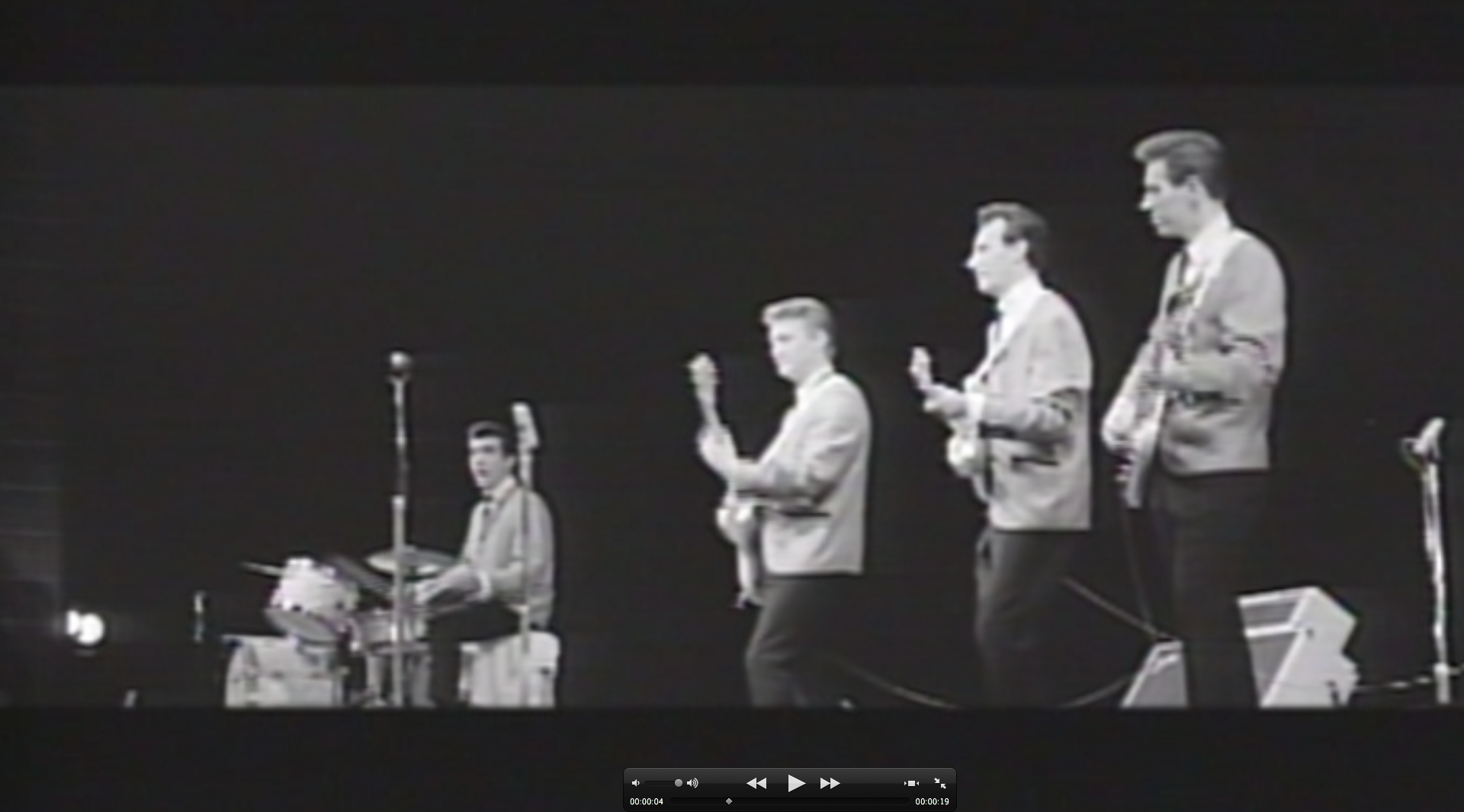

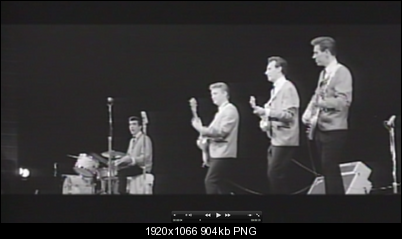

    I understand it wouldn't have been realistic to expect them to deliver DV with no borders top and bottom. But couldn't they've made a capture like this:
Name:	Schermafbeelding 2013-11-02 om 15.42.25.png
    If they'd done it this way there would have been no need for my player to add black bars at the left and right to fill my 16:9 screen. And in that case I would have had more picture and less black bars.
    In fact this is what I have asked them to do. But maybe it isn't possible to do this during capture?
  30. They could provide a 16:9 DAR DV file like you've pictured. But that requires that they crop part of the black borders and resize vertically. Since they are scaling interlaced frames using a simple algorithm (separate fields, resize, and reinterlace fields) they are creating nasty artifacts at sharp horizontal edges. Since this is a film source it would be better to inverse telecine back to progressive film frames, upscale, then reinterlace (if necessary). If it was me, and I wanted DV, I'd have them deliver a 4:3 NTSC DV -- that's closest to what's on the laserdisc. Then I'd do the filtering myself.
    The issue for you is whether you want invest the time to learn the filtering tools and techniques (and cost if you want to use commercial tools) or if you are willing to accept second rate scaling by them.
