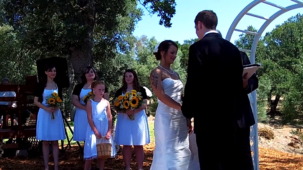

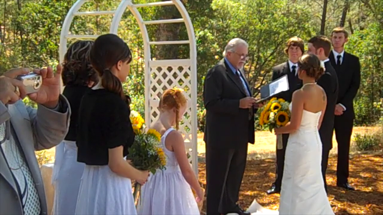

    Not sure if "color temperature" is even the right term, but basically I have two cameras on one event. One came through "warm" and the other came through "cool." This is a very amateur, impromptu shoot with low quality gear--I really don't expect much, but I thought there might be an avisynth filter or something to warm up the cool roll to match the main camera. I'm not going for perfection, maybe just an adjustment to make the cuts a bit more natural.
    Sample screenshots attached.

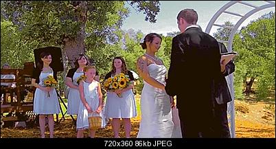

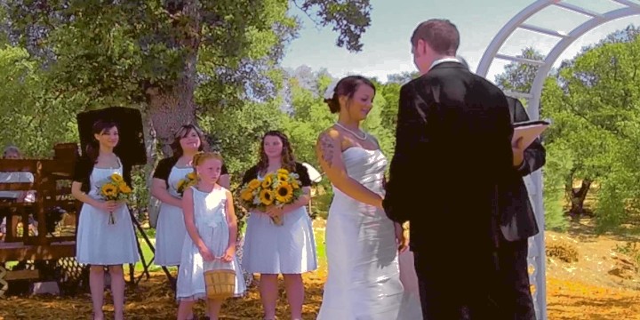

  8. You could try using the ColorLike() filter in AviSynth. The "cold" image warmed up with ColorLike():
    It will probably work better with the source videos, and it needs further adjustments, but it's much closer.
    warm=ImageSource("warm.png").BilinearResize(720,360).ConvertToYV12()
    cold=ImageSource("cold.png").BilinearResize(720,360).ConvertToYV12()
    #part 1, build histograms
    #warm.WriteHistogram("warm.txt", 1)
    #cold.WriteHistogram("cold.txt", 1)
    #Interleave(warm,cold)
    #part 2, make cold look like warm
    Interleave(warm,cold.colourlike("cold.txt", "warm.txt"))
    [Attachment 20933 - Click to enlarge]
    Wow, that looks really good. I think the colors are just right. Maybe just a touch of contrast and it's definitely good enough for this project. Thanks a lot!

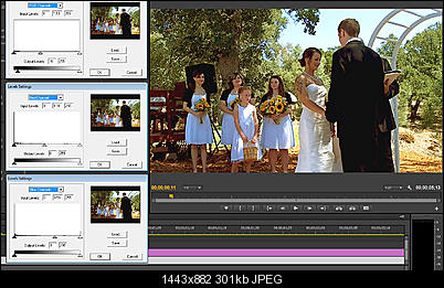

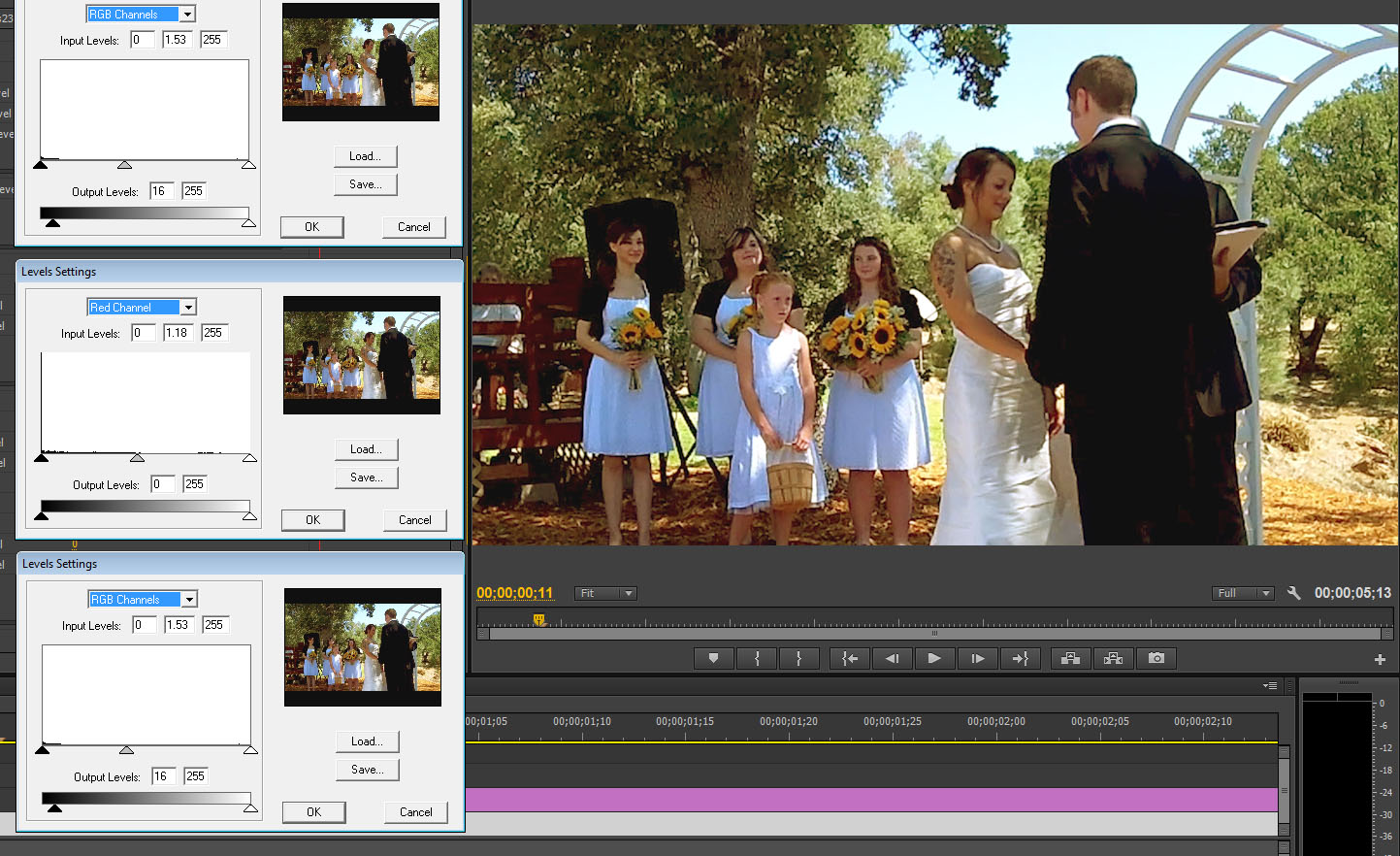

  17. If you do want to try the copy and paste attributes route (rather than the cut and paste clip route) simple gamma adjustments in the RGB, Red, and Blue channels will give you a matching image. Here is an example from Premiere, but using only simple level controls such as those available in iMovie. (You may even be able to simply copy the numbers)

  18. Originally Posted by smrpix View Post
    That looks pretty good. Close equivalents in AviSynth:
    ConvertToRGB()
    RGBAdjust(rg=1.18, bg=0.59)
    Levels(0,1.53,255,16,255)
    Adjusting the levels before conversion to RGB may keep the blacks from getting crushed. Or use ConvertToRGB(matrix="PC.709") to avoid the contrast stretch, then adjust gamma and levels accordingly.
    And one last note, the bright sky in the cold picture is causing the rest of the image to be darker. So you may not need as much luma gamma adjustment in other shots.

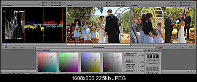

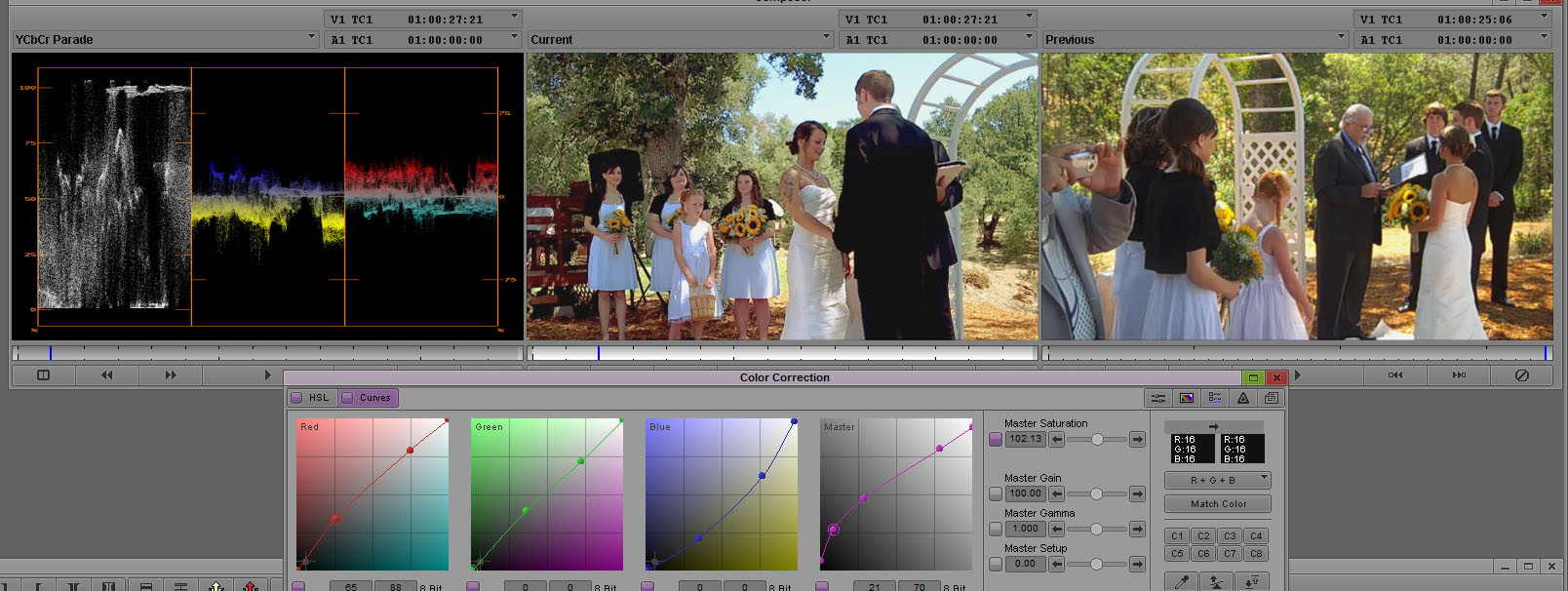

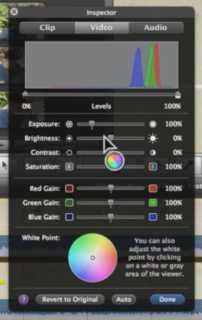

  22. Originally Posted by budwzr View Post
    That Premiere is ridiculous with all those boxes within boxes. Geez, that's confusing. I can't even tell what's what.
    The multiple boxes are a) a composite image, you can actually only display one at a time and b) they don't need to be revealed at all except c) they ROUGHLY replicate what you see in iMovie.
    Compositing it this way (I felt) made it easier to understand the parameters.
    Like you, I prefer curves, but I don't believe they are available in iMovie's color corrector.
    iMovie color corrector:
    My first go round (too complex):

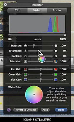

  23. Wow, thanks all. I see some really good results, certainly good enough for my little dinky project.
    Here's where I stand:
    I can go about this two ways. I can either adjust the colors directly in iMovie, or run the camera B's roll (the "cool" footage) through some Avisynth goodness.
    Other NLEs are out of the question, as I have already cut the sequence in iMovie, and I don't have budget for a replacement.
    The latest iMovie (IIRC 10.0) has very simple color correction options. I may have missed the advanced options, but I didn't see per-channel adjustments (just brightness, saturation and color temperature)
    Avisynth is looking like a good option, thanks to jagabo for some script suggestions. I'm still not 100% on how best to produce the "warmed up" clip.
