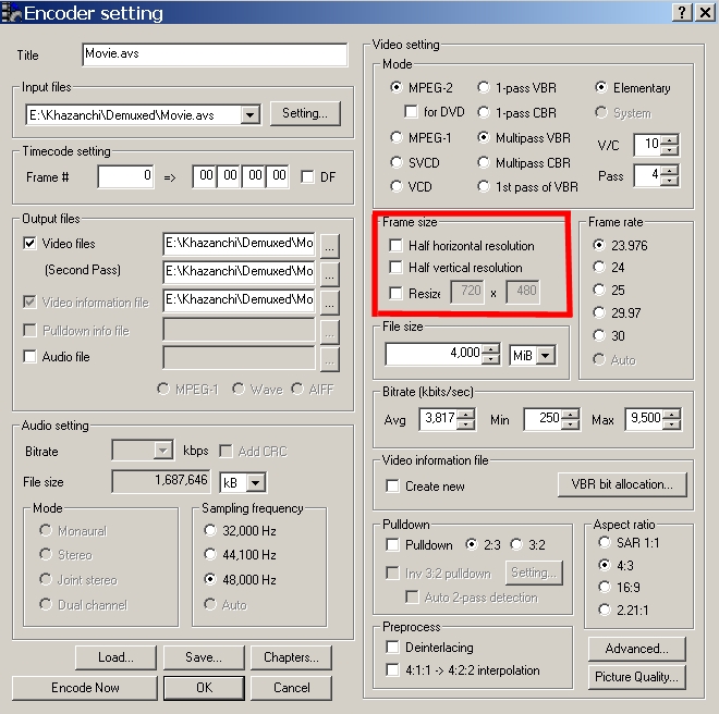

  13. Why do any resizing in CCE if you're feeding it a 720x480 script? Uncheck the all the 'frame size' boxes in CCE.

  15. Originally Posted by tebugg View Post
    i am using cce sp2
    Me too.

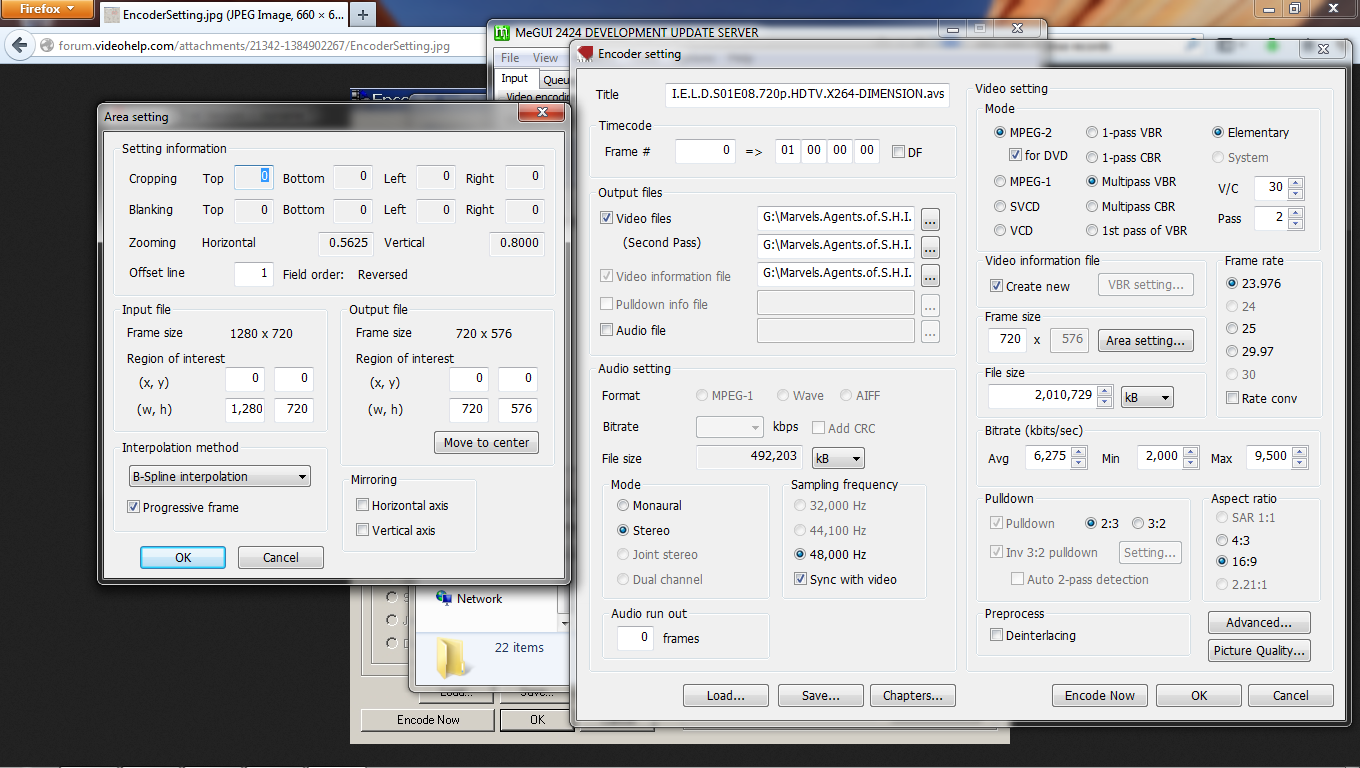

    Feb 2011
    kalamazoo, michigan
    i am using cce sp2
    Me too.
    weird. i dont have that option. here is a screenshot of what my cce sp2 looks like. the left window is the window from clicking on area settings.

  17. Yeah, interesting. I guess at some point they changed the Encode Setting screen. My pic is from CCE.SP.v2.70.02.12.
    I'm assuming V2 is the same as SP2. Maybe I'm wrong. Anyway, do everything in the script, resize, IVTC or deinterlacing if necessary, any other filtering, etc.
