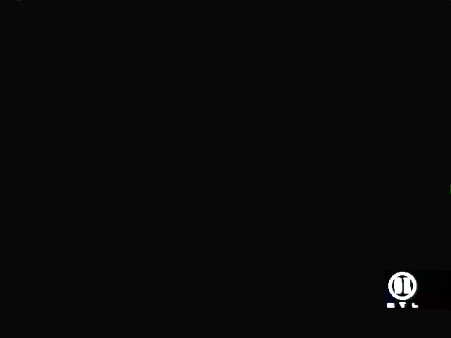

  14. Load_Stdcall_plugin("C:\Program Files (x86)\AviSynth 2.5\plugins\AVSInpaint.dll")
    avisource("sample.avi")
    rm_logo(logomask="C:\Users\sekininsha\Desktop\logo \log_1.bmp", loc="br", cutsize="small", par=1.0, mode="both", percent=25, PP=1, debug=false)
    http://avisynth.nl/index.php/Rm_logo
