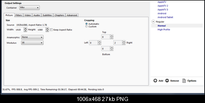

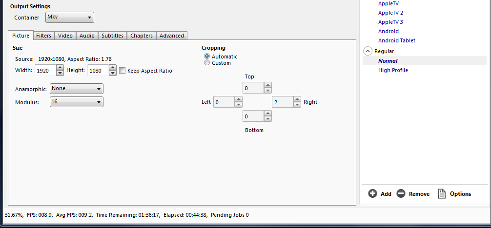

  5. I didn't think Handbrake would let you specify a mod8 size with the Modulus set to 16. In any case, 1920x1080 is fine for h.264 video.
  6. This is how I have it set for an encode that is running right now...

  7. Not sure if you're interested in the above image, but, thought I'd include it anyway...
    Thanks for your help
