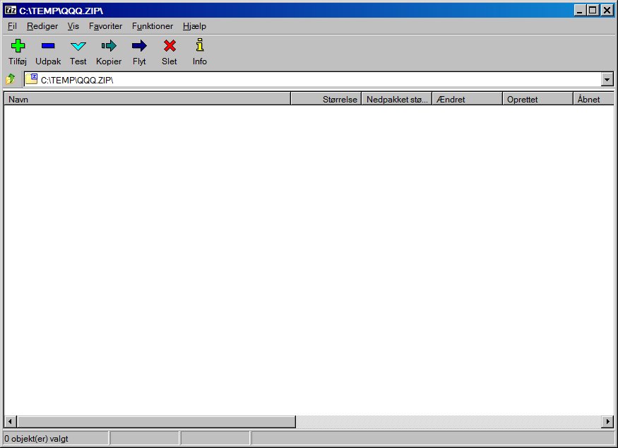

  4. you can not have an empty archive.
    I can

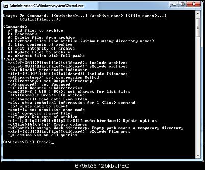

    I have 7zip, always have, but it is not associated with zip files, I usually only use 7zip with 7zip files.
    So exactly how do I run it with a command line ?
    Do I need to run it in the same folder with the zip files ?
    It has a section in the help file on running command lines and I am going to read it now, but a step by step for dummies would be great

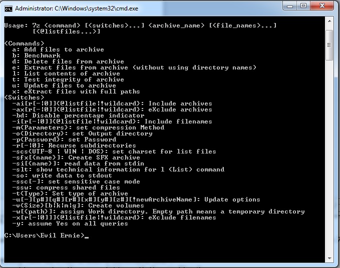

    EDIT:
    So I have the command line/window open,
    I have all the zip files in a folder in the root of C:
