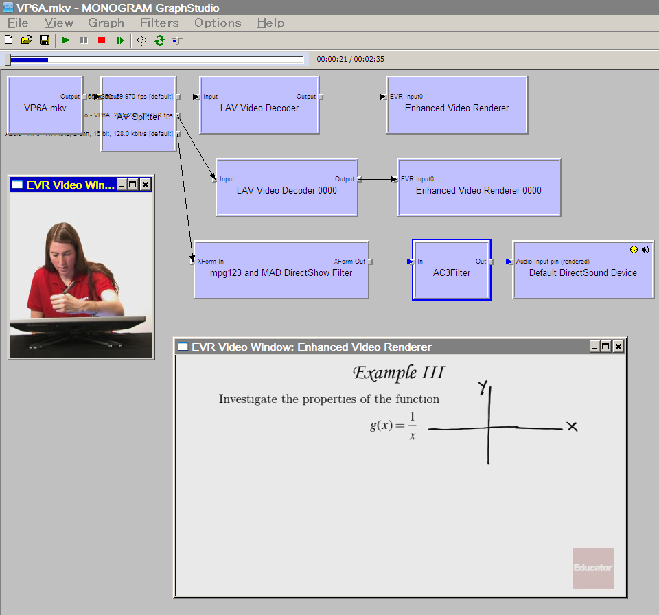

    Okay, now I've managed to view the DAAAAMN file, and that's a start.
    For the notes:
    I really need more buckets of coffee ,
    I hadn't noticed the Mediainfo report in post #1 already had said the MKV file contains TWO video streams.
    Anyway:
    The pesky MKV plays fine with MPC-HC + LAV Splitter + LAV Video (VP6 decoder enabled).
    Assuming you're interested only in the higher-resolution stream, you can just remux the files through MKVmerge, discarding the low-res video, and you don't even have to change the Fourcc. O.T.O.H., since the higher-res video is the default stream already, why waste time with remuxing?
    But if you want to watch both streams at the same time, then the re-encode is inevitable,
    and A.T.M. I can't think of any "easy way" to automate the whole process for a batch conversion

  21. VP6A playback test results in various video players:
    Potplayer, MPC-BE, KMPlayer, SMPlayer was possible to play the sample but MPC-HC and VLC was impossible.

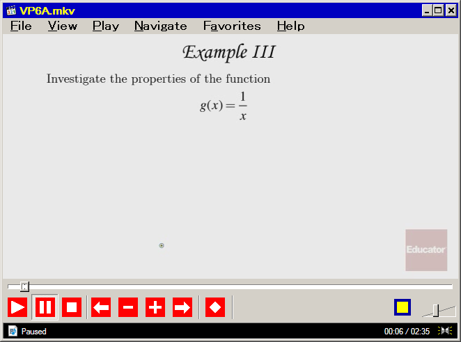

    Notwithstanding, if you happen to prefer AV Splitter to LAV Splitter....
