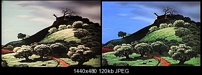

  18. 1) Of course I am aware of PC/TV levels. 2) I do know something about color theory. 3) I do know the proper use of things like histograms. 4) I didn't post a sample video. 5) The darks are crushed through out the movie (Japanese LD), not just the beginning. And I am aware that it cannot be repaired.
    The Aug.2009 post was made on my own website. Sorry I wasn't clear about that. Here is a comparison shot (one of four that I referenced in my above comment). Japanese LD is on the left, PAL VHS is on the right.
    No amount of tweaking can make the levels on the LD look as good as the VHS. The colors are so faint that it almost looks grayscale at times. The luma levels are crushed so badly that the dark info is just lost. And the mid levels are muddy too.
    But I don't intend to hijack this thread which is about NTSC/PAL conversion. I was only answering jman98's question.
    If I can find it when I get home, I will post some AviSynth scripts I made which helped. I made a script once that reversed the improper PAL conversion perfectly on a Road Runner/Coyote cartoon. Why it was PAL in the first place baffles me.
