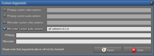

    Using 3.6 64bit portable version I managed to do what you want. But there is a bug in TEncoder and because of that bug you should place a space before custom arguments. And there is no need for ",' or any other symbol. Here is the configuration that works for me:

    I've now tried different MEncoder args with the leading space, and I can't get the volume to change. It seems a bit strange that after clicking on "Reset" and confirming, the space where I just typed in the args is blank.
    I'm using version 3.6.0 x64 portable on Win7 x64, trying to save a .mkv file to .avi using xvid . If you would like, I can email you a log file or even the small test files I'm using. Or I can start a new reply to the other support thread you mentioned. Let me know. I would really like to get the change volume issue solved.

    You shoulndt hit "reset", it will, well, reset values. Just close the window after entering arguments.

    Yes, it works now. Thank you for your help.
    Could I suggest changing the Close button caption to 'OK'? It might be more intuitive that way.
    By the way, if you set the Args, close the program and then reopen it, the Args that you typed in are still there but they're now missing the leading space. JFYI. Thanks again.

    Yup, changed it to "OK".
    BTW I remembered something. Audio and video options are added to the end of command chain so they should have a space before them (for mencoder), they are for codecs. So you should write your input to "Mencoder" text box, this way there won't be a space problem.
